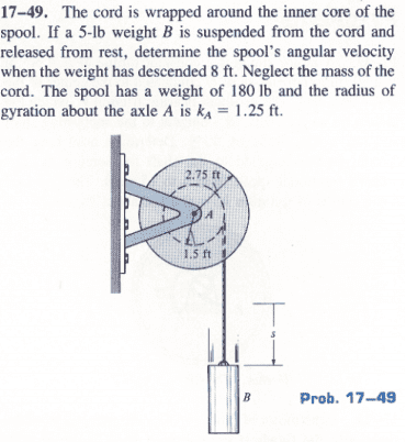

Alright, so the solution manual shows that the intertia of the disk is:
I = m * k2, where k is the radius of gyration​
However why can't the inertia of the disk be:
I = 0.5 * m * r2, where r is the radius of the disk​
This is the formula for the inertia of a rotating disk... However when I plug in all my numbers I get a different inertia value when compared to the inertia value that I got using the radius of gyration.
Because the spool is not a uniform disk. You don't need to know why it's not uniform, just accept that you are given the effective radius.
Ah okay, I wish it said that the density is not uniformly distributed... But thanks!
