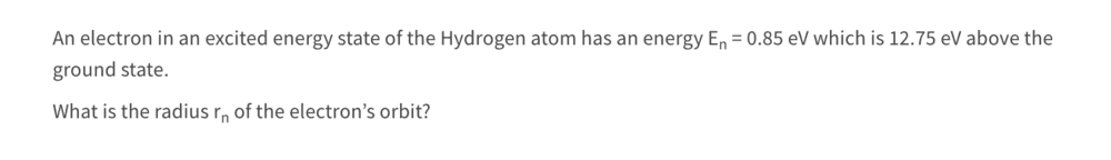

See question below
F = mv^2/r
I am really stuck on what to do here in this question

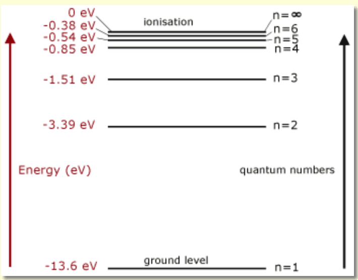

I know that I shouldn't be looking at this but here is the energy level diagram for a hydrogen atom
Therefore I know that my energy En = –0.85eV is in the 4th energy level hence n = 4

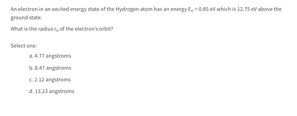

Also I should've showed the full question in the original post by showing the possible answers to choose from
Here it is
As you can see there isn't any 0.529 angstrom option here? Does this question have an error then? I thought option b would've been the correct answer.
You misunderstand. The answer you provide is correct. The Bohr radius is the size of the n=1 (ground) state. I was pointing out there was an easier route to your answer but all correct routes will provide the correct number!
