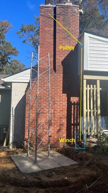

I was planning to put the winch below the pulley.
I've attached a pic. The base was poured on 10/20. A contractor reinforced the attachment point for the pulley since we had to rebuild this side of the house due to a tree that fell in Aug.
The winch cable should be about 25'. The winch power depends on the lift load. I'm looking at the Dutton-Lainson WG2000 Worm Gear Winch | Hex Drive | Std. Reel https://www.dutton-lainson.com/proddetail.php?prod=11001. for horizontal pulling and vertical lifting applications.

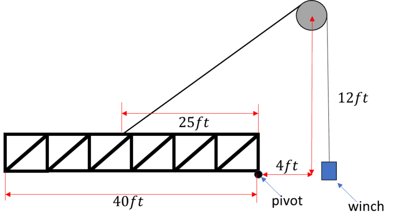

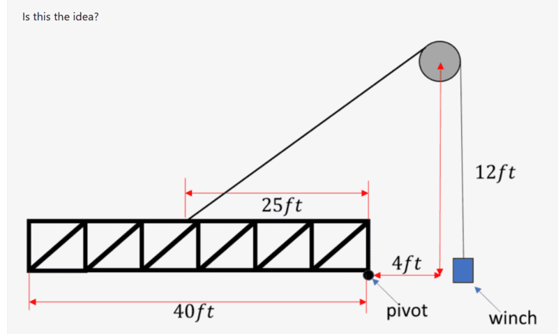

Is this the idea?
Likes DeBangis21, ak3b, BvU and 1 other person

Sorry, I'm having trouble visualizing the lifting operation. That looks to be about the bottom 12' of the tower, right? Are the bottom 2 legs that are opposite the pulley hinged? And if so, is the idea to lower that first 12' of tower, build the rest of the tower on the ground, and then tilt it up left-to right using the 2 hinged leg bottoms until it's vertical and then make the 3rd leg connection?
EDIT -- @erobz beat me to it!
Likes erobz
Yes. That's the first 10' section.

Okay, so it's like balancing a teeter-totter. You want the sum of the weights multiplied by the distances from the fulcrum (the center of gravity) to be equal on both sides of the fulcrum. So if most of the weight is near the top of the tower, the center of gravity will also be closer to the top than to the center.
Figuring out the center of gravity of the tower helps us write the equations that show how much tension it takes in the cable at different angles as the tower is raised, which helps us figure out the best point to anchor the cable onto the tower to minimize the tension over the course of the lifting operation.
ak3b said:
The tower weighs 124 lbs. The antenna is 25 lbs, the rotor is 8 lbs, the cables are roughly 50 lbs.
So draw a sketch of the tower laying down on the ground. The distributed weight is 124+50 lbs from the mast and cables, and there is an additional 25+8 lbs concentrated at the left end (top of the tower). Does that sound right? If that's right, my sketch shows a weight of 174 lbs concentrated at the center of the tower (representing the distributed weight), and a weight of 32 lbs concentrated at the top (left side) of the tower. We can just find the balance point of these two forces on the laid-down tower to find the center of gravity.
When I do this, it looks like the center of gravity of the tower is about 24' up from the base. How did you decide on the 25' mark as an attachment point? That's pretty close to the CG!

So for a ballpark number, stealing the sketch from @erobz in Post #5:
If I subtract about 2' for the width of the tower (is that about right?), then we can calculate the angle ##\theta## where the cable attaches to the tower when the tower is on the ground:
$$\theta = tan^{-1}\frac{10'}{29'} = 19^o$$
So then we can calculate the tension T in the cable as it starts to lift the weight of the tower (centered approximately below the lift point):
$$T = \frac{206 lbs}{sin(19^o)} = 633 lbs$$
Likes DeBangis21, erobz, pbuk and 1 other person
BTW, assuming that that we do still end up with about ##633 lbs## for the initial lifting tension in the cable after some discussion, you would obviously need to size things to include reasonable safety factors. That includes the mounts for the pulley and winch. (Speaking from personal experience here after helping to erect many large and heavy antennas for Field Day and at fellow HAM's homes, sometimes antenna masts bounce as part of the process...) :wink:

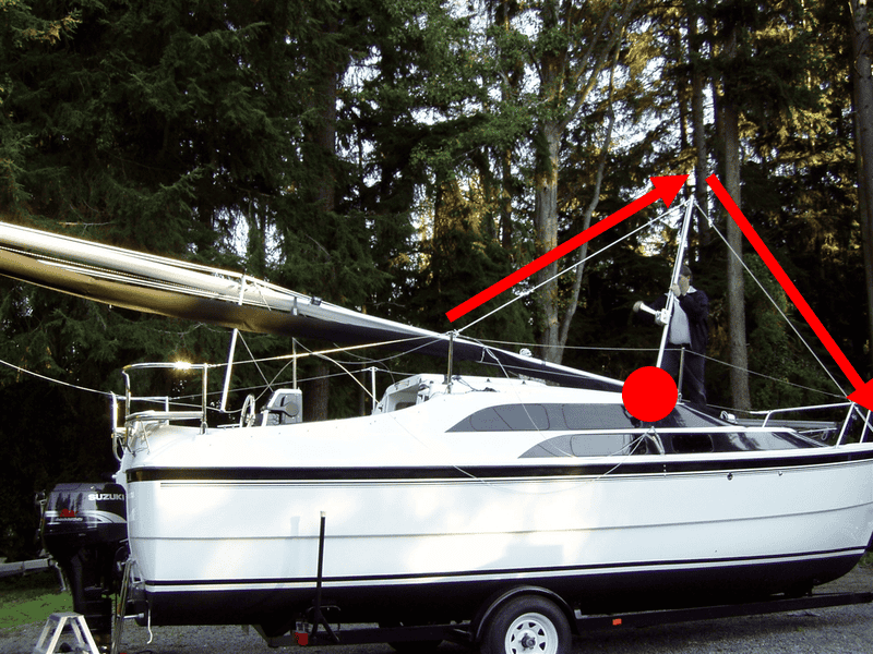

I was helping to erect a large and moderately heavy antenna mast at Field Day a few years ago, where finishing the setup involved pushing a locking pin through the base and the mast as it reached vertical. The person with that assignment missed, and the mast came down as slowly as us puny humans could try to manage it. Kind of bent the 10m antenna at the top of the mast, but no puny humans were harmed in the "mishap"...
I do this with my 30ft. (boat) mast twice a year. Of course, it only weighs about 100lbs.
I do it by hand using a 4:1 pulley system.
This is not me and this is not my boat.
This anecdote is of absolutely no use to you.

Yes. The wall where I will mount the pulley was reinforced with 2x6s when they rebuilt the roof. Of course, I missed the opportunity to install the eye bolt before they replaced the porch ceiling with plywood. So I either take the plywood down to get the bolt in place, or I use lag bolts, which makes me nervous. So, I'll probably be taking the plywood down. I will replace the corner post, which was damaged from the tree, with a 6x6. I'm looking for a mount to bolt to the concrete porch and screw the 6x6. I want to install the winch on this post.

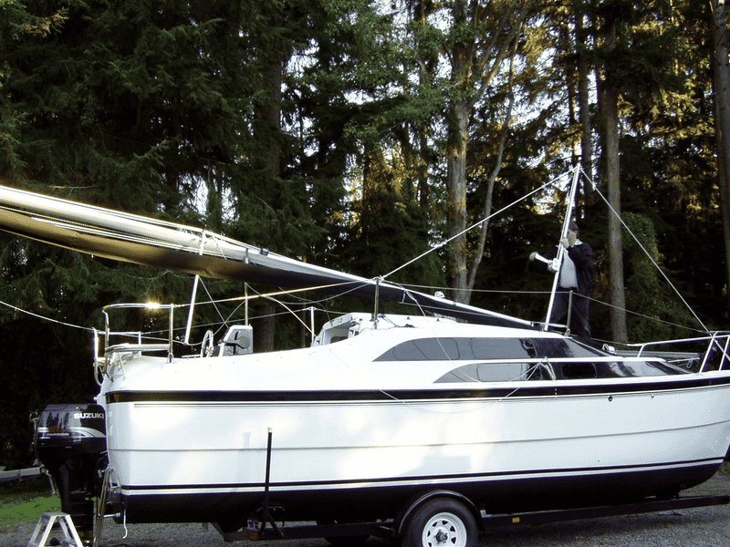

Yeah. Cam cleat, not ratchet. Maybe when I get older and weaker, I'll use a manual winch but it's not really necessary (except for the last two inches).
I use the 4:1 mainsheet with fiddle blocks and integrated cam cleat.
The 4:1 fiddle blocks provide enough advantage (as well as friction) that lowering it can be done one-handed, and the cam cleat acts as an automatic brake.

sophiecentaur said:
On a boat, you have nowhere to place a pulley
That's why a Mac comes with a mast-raising pole as standard equipment.
Mine is about 6 feet long, pivots on the mast step plate.
I'm wondering where the OP's pulley is attached. Sky hooks would be ideal for sailing but you can find them on the sides of buildings - it's another world on land.
The original Westerly centaur had a massively over-specked mast and it was not intended for bridges or for towing (two massive iron keels) so the mast raising pole was not standard equipment, afaik).
Likes sophiecentaur
  • #34
Sorry I missed that image. Another thing to reduce the extreme of tension the lifting from the ground would be to use a pole or A frame, starting at say 45 degrees elevation - like the boat mast lifting gear. It would make things much less dramatic and stressful on the pulley fixing.
