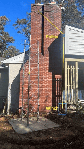

berkeman said:
The hardest part is when the tower is on the ground, because the angle θ is the sharpest.
Lifting it off the ground manually and resting it on a prop (or another person) can take care of the worst case of theta is zero). They can also hold a rope to control rotation when near vertical.
Basically there's no substitute for a few spare muscular blokes for these events.

sophiecentaur said:
I'm wondering where the OP's pulley is attached.
  • #34
Sorry I missed that image. Another thing to reduce the extreme of tension the lifting from the ground would be to use a pole or A frame, starting at say 45 degrees elevation - like the boat mast lifting gear. It would make things much less dramatic and stressful on the pulley fixing.
