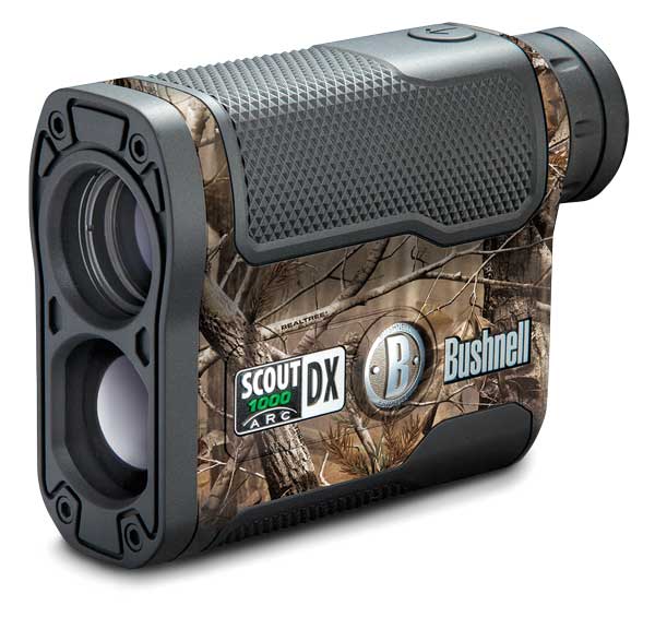

If you can't get a reliable reflection (of light, radar, ultrasound, etc.), then your next best technique is probably optical
triangulation. Have you looked into optical triangulation yet? It is commonly used in animal hunting range finding applications, for example...
Like this...
http://www.bowhunter.com/wp-content/blogs.dir/3/files/new-rangefinders-for-2013/01_bushnell.jpg
