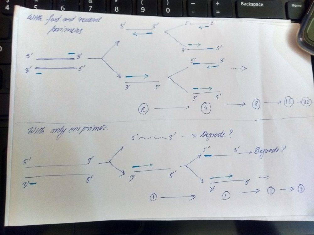

This post is several months old now, but I must admit I didn't completely get your last reply.
I have tried to depict my understanding through this illustration below:
244283
So, with one effective primer (in absence of reverse primer binding site) PCR products are not formed. Am I correct?
With only one primer, you will get products extended from the single primer, but they will only amplify linearly not exponentially. They will also NOT be of all the same length.
On a gel, if a band is visible (due to fewer products from linear amplification), the band will be more diffuse because of the different lengths of the products.
If there are two primers that direct the polymerase TOWARDS each other, they will be predominately amplifying not the original very large pieces of starting DNA and it first products, but will be duplicating the DNA pieces from a previous round of amplification where the end of the piece being amplified is defined by the location of the first primer that was used to amplify the DNA in the opposite direction.
Again, this will only work if the primers are close enough to copy DNA extending to the location of the second primer. Many versions of the enzyme will only go so far before stopping and falling off the DNA. If the pieces produced do not enclude the second primer site, the secnd primer will not be able to bind the DNA and trigger another round of amplification.
I understood that the PCR products from a single primer will not be of the same length and the band observed due to those will be diffused if there's linear amplification, but I don't get how there will be a linear amplification of dsDNA.
With reference to my illustration, shouldn't the single-stranded DNA which lacks the reverse primer binding site increase linearly?
Sorry, I forgot to mention that the DNA sequence of interest lacks the reverse primer binding site.
NOt sure I am understanding your question correctly, but does not your picture of the ssDNA amplify linearly (1 + 1 + 1 + ...) as it is copied in each round?
dsDNA in a PCR protocol would be heated to become ssDNA after which it would interact with reaction mixture.
