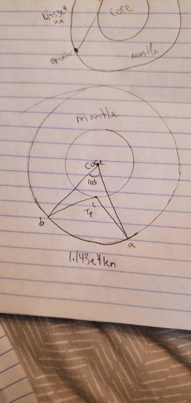

I've attached a figure I've made; I know I'm to assume the Earth is a perfect sphere in this case. Assuming the 103 degrees is measured as latitude, I've calculated the distance in kilometers (Xp in the second equation above) to be 1.1453e4 km. I know I need u = p at the turning point, but not where to go from here. I'm not convinced this figure is correct, but I'm doing my best.
The top of the upper diagram is cut off, and I do not understand the lower diagram. The angle marked as 103° is clearly less than 90, and there is no basis given for the wider angle where there seems to be a reflection off the core.
From what I can see of the upper diagram, it looks more like what I expected to see, but I've no expertise on this subject, so I could be wrong.
