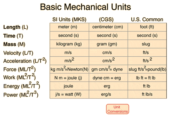

Note: When in doubt, look at the units you'll get after the math operations to see if that makes sense.
Check out this from here:
http://hyperphysics.phy-astr.gsu.edu/hbase/units.html"
