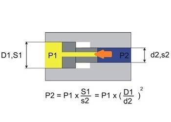

Is this what you need?
http://www.hydroprocess.fr/images/amplification-pression.jpg​

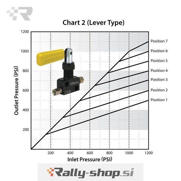

If you need to keep the same fluid on both side, it can be transformed into a proportioning valve by putting a hole through the piston and a metering valve at the inlet (in orange) like this:
Every time P2 increases, it pushes the piston and opens the metering valve. As the pressure P1 builds up, it moves the piston back and closes the metering valve. A greater P2 needs to be created to open it again and increase P1 again (which is always smaller than P2 according to the diameter ratio). Brake systems use a similar valve, except that there is a spring acting on the piston (in the white zone) such that the pressure ratio is 1:1 up to a threshold pressure and then the proportioning starts once P1 X S1 is greater than P2 X s2 plus the spring force, which give an output as shown below (the valve shown can adjust the spring preload with the lever and thus change the threshold pressure):

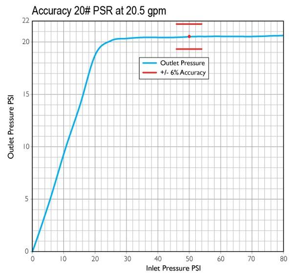

http://www.advancevalves.com/large-size-balancing-valve.aspx. A regulator keeps a constant output pressure no matter the input pressure as shown below.
?u=http%3A%2F%2Fwww.senninger.com%2Fwordpress%2Fwp-content%2Fuploads%2F2010%2F05%2FAccuracy4.jpg
