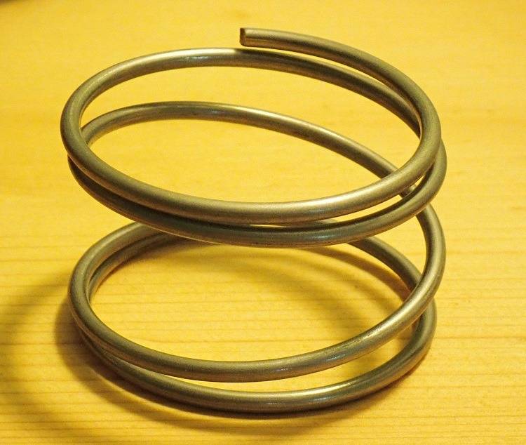

Yes, and inversely proportional to the third power of the major diameter. Winding your own spring is a good DIY project, and you can buy spring wire from McMaster-Carr (or other sources). The photo is my first attempt at winding a replacement spring for a trash pump mechanical seal:
The largest learning experience was to release the tension before cutting the wire. The snapback distorted this spring, so I had to make another one. The second one did the job. The wire is 0.120" diameter stainless steel spring wire.
