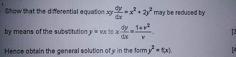

for this question, i 'm only able reduce it to become x dv/dx = (v^2 + 1) / v ... i have checked it several times, i just couldn't find my mistake...
