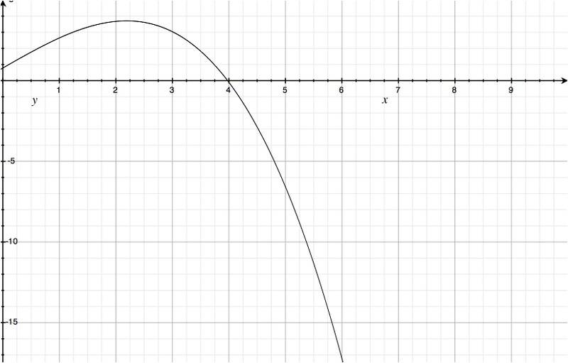

The angular displacement θ is a cubic function of time, which means that if you plot θ vs. t, starting at t = 0 you get something like what's shown in the attached plot. That's all. What is it about the functional form being a cubic that is throwing you off?
