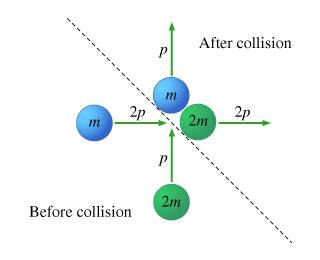

Two particles move perpendicular to each other until they collide. Particle 1 has mass m and momentum of magnitude 2p , and particle 2 has mass 2m and momentum of magnitude p . Note: Magnitudes are not drawn to scale in any of the figures.
Suppose that after the collision, the particles "trade" their momenta, as shown in the figure. That is, particle 1 now has magnitude of momentum p , and particle 2 has magnitude of momentum 2p ; furthermore, each particle is now moving in the direction in which the other had been moving. How much kinetic energy, Klost , is lost in the collision?
Express your answer in terms of m and p.

Diagram of a two-particle collision: before collision, a blue sphere of mass m moves right with momentum 2p and a green sphere of mass 2m moves up with momentum p; after collision, the blue sphere moves up with momentum p and the green sphere moves right with momentum 2p.
I'm having trouble relating the momentums and kinetic energies. If someone can provide a little guidance, that would be great.
Since that collision seems to be elastic, I'm assuming that the kinetic energy of the system is being conserved.
Figure out the change in speed of each mass. For example: If the 1m mass has initial speed of v (and initial momentum mv), what's its final speed if its momentum is now 2mv?
Then just crank out the kinetic energies of each mass before and after the collision and find the difference.
(Be sure to express your final answers in terms of the given data: the momentum p and mass m.)
Alternatively, just express the KE of a particle in term of its momentum and mass. Then you can compare the KEs directly.

I don't know why you think it seems to be elastic, but it's not. (If it were elastic, there would be no change in KE. Calculate it and see for yourself!)
the Ek lost is equal to the Ek initially minus the Ek final.
get an equation from this, and substitute the speeds in this equation by m and p.
e.g. 2p = m*u1
u1 = 2p/m
where u1 is the initial speed of mass m.

Here's my processes, but I'm not getting the right answer.
Initial velocities:
1)ball of mass m ---> 2p = mv ----> v = 2p/m
2)ball of mass 2m ---> p = mv ----> v = 2m/p
after collision
Final velocites:
1) ball of mass m ---> p = mv ---> v = p/m
2) ball of mass 2m ---> 2p = 2mv ---> v = 2p/2m ---> v = p/m
Using conservation of Kinetic energy theorem:
(1/2)m*(2p/m)^2 + (1/2)2m*(2m/p)^2 = (1/2)m*(p/m)^2 + (1/2)2m(p/m)^2 --->
[(1/2)m*(2p/m)^2 + (1/2)2m*(2m/p)^2] - (1/2)m*(p/m)^2 + (1/2)2m(p/m)^2 = [tex]\Delta[/tex]K
Simplified=
(2p^2)/m + (4m^3)/p^2 - (3p^2)/2m
...am i on the right track?

You flipped this one around; it should be: p = (2m)v ---> v = p/2m

Yes, you're on the right track.

So with the correction I'm getting:
2p^2/m + p^2/4m - [(p^2/2m) + (p^2/m)] -->
9p^2/4m - 3p^2/2m -->
3p^2/4m
how's that look? I'm running out of attempts on my web assignment ;)
Doc Al said:
Looks good to me.
It was right, thank you!

It better not be! A completely inelastic collision is one that loses the most KE.
What's the final speed after the collision and how did you figure it out?

Your error is assuming that you can just add the momenta as if they were just numbers: 2p + p = 3p. Nope!
The momenta are vectors and you need to add them like vectors. Find the resultant total momentum and use that to figure out the final speed.
