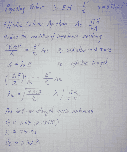

Herculi said:
But, i don't know where does the length of the antenna L comes in! Why is it important and where should i insert it? Please give me a tip.
I think you should use the effective length of the antenna to find the open circuit voltage appearing on the antenna terminals.
https://en.wikipedia.org/wiki/Antenna_aperture#Effective_length
I think that in general, multiplying the electric field strength by the physical length of the dipole antenna can already get a reasonable approximation, but if we want to look at it from another angle, the following calculation method is also worthy of reference (I hope I am not mistaken).
