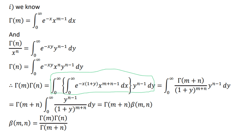

TL;DR
Proof of Beta Gamma function relation
So, my teacher showed me this proof and unfortunately it is vacation now. I don't understand what just happened in the marked line. Can someone please explain?
The line asserts that [tex] \int_0^\infty e^{-x(1+ y)}x^{m+n-1}\,dx = \frac{\Gamma(m + n)}{(1 + y)^{m + n}}.[/tex] How would you apply the given formulae to arrive at that?
