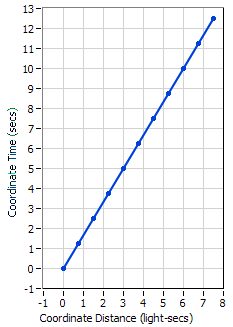

And here is my diagram that corresponds to a clock at rest at the spatial origin of a frame that we will call frame K' to be consistent with Einstein's nomenclature:
Note that x'=0 is the Coordinate Distance of the clock which stays at 0. The first two blue dots at the bottom correspond to the Coordinate Times of t'=0 and t'=1. Any questions about this so far?
Next, Einstein uses the Lorentz Transformation process to see what the new Coordinates, x and t, are in a new frame, K, moving at speed v with respect to the first one. I used a specific value of v = -0.6c to make the second diagram for frame K:
Just in case you're not familiar with the Lorentz Transformation process, I will go through the details:

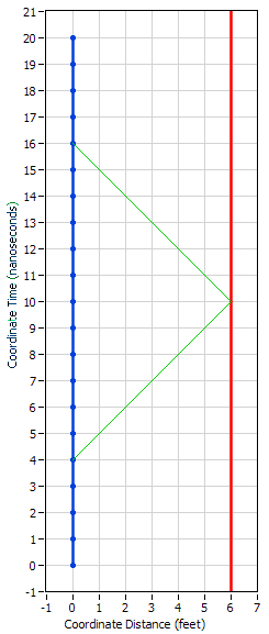

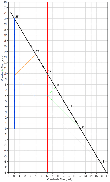

OK, here's a spacetime diagram for an IRF in which the observer and mirror are at rest showing one tick of a light clock:
At time 4 nanoseconds, the observer in blue at location 0 sends a flash of green light to a red mirror that is six feet away from him. He gets the reflection back at time 16 nanoseconds so each tick is 12 nanoseconds long.

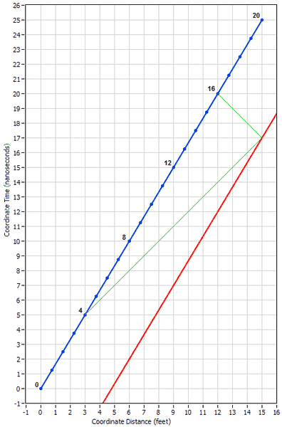

Now let's see what happens if we view the same thing in an IRF moving at -0.6c with respect to the original IRF:
Now the observer and his mirror are moving at 0.6c. Notice that the distance to the mirror is Length Contracted. Instead of six feet it is only 4.8 feet. Be sure to measure this along a horizontal line where the Coordinate Time is a constant. Also notice that the observer's time is dilated, that is, it takes longer in the diagram to mark of the same Proper Time from the first IRF. Finally note that the flash of light propagates at c along a 45-degree angle in both diagrams and so the observer continues to experience exactly the same thing in this diagram as he did in the first one. He sends the light signal out at 4 nanoseconds of his Proper Time and receives the reflection at 16 nanoseconds of his Proper Time.
Does that answer your question?

I discussed this for the scenario of the observer and his mirror:

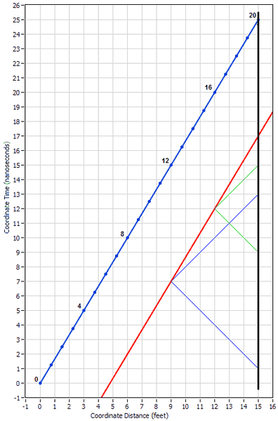

ghwellsjr said:
Thanks, I'm glad you liked them.
Now I want to take that same diagram that depicts the situation that adjacent described in his Opening Post (OP) and show you how it depicts the Length Contraction of the distance between the "person" in blue and the mirror in red which the "person" measured to be 6 feet with his ruler. There are a couple ways that other people, stationary in the IRF in which the "person" is moving can make this assessment. They both involve radar measurements. This is similar to the way a cop can clock you for speeding. It works by sending a light (or radar) pulse at an object and waiting for the return echo and then measuring how long the round trip took and dividing it by two and assuming that it took the same amount of time to get to the object as it took for the light to get back from the object. So we place the time of the measurement at the midpoint of the measurement and we consider the measurement of the distance to be how far the light traveled in the measured amount of time. By making successive measurements, we can establish a speed.
Here's the first spacetime diagram:
I have drawn the second observer as a black line at coordinate distance of 15 feet. At coordinate time of 1 nanoseconds, he happens to send out the first radar pulse in blue and a short time later he sends out the second radar pulse in green at 9 ns. He receives the first reflection at coordinate time of 13 ns and the second one at 15 ns. After doing the calculation I previously described, he calculates that the mirror was 6 feet away at time 7 ns and it was 3 feet away at 12 ns. The differences between these calculates establishes that the mirror is moving toward him at 3 feet in 5 ns. which is 0.6 feet per ns or just 0.6c.
So now, armed with the measurement of the mirror's speed of 0.6 feet/ns, he waits until the mirror reach him which happens at time 17 ns. Then he waits for the "person" to reach him which happens at time 25 ns. Since it took 8 ns for the object to pass him at 0.6 feet/ns, he concludes that its length is 0.6 times 8 or 4.8 feet, the same as the gamma process determined.

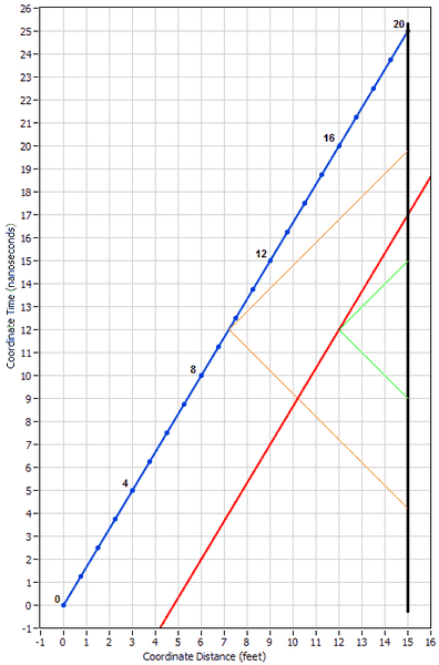

Now I want to show you another way. This involves measurements of both the "person" in blue and the mirror in red taken at the same "time":
First, the observer in black sends an orange radar pulse at time 4.2 ns and a second green one at time 9 ns. He receives the echoes at 15 ns and 19.8 ns. He concludes that the blue "person" is 7.8 feet away at time 12 ns and the red "mirrors" are 3 feet away at the same time leaving a difference of 4.8 feet.
All methods agree.
