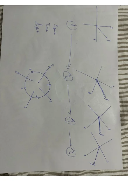

I am confused about why event horizons and the time direction cannot be observer dependent near black holes.
Hello everyone,
I have no formal training in theoretical physics or advanced mathematics. I have been trying to build intuition about general relativity, especially black holes and event horizons, by reading popular and semi-technical sources.
While reading that time and space effectively exchange roles inside a black hole, I tried to form an intuitive picture of how this can be understood physically. In the process, I found myself considering a way of thinking in which the accessibility of events near the horizon seems to depend on the observer’s position and motion.
My intuition keeps getting stuck on the following point: as different observers use different local frames, the same position-time graph of a light ray appears differently when projected onto their local coordinates. This line of thinking also seemed to account for effects such as the apparent ‘freezing’ of light near a black hole, or the way its coordinate speed can appear to approach zero for a distant observer. In the same way, it appeared to offer an intuitive explanation for why infalling objects seem to take an infinite time to cross the event horizon when viewed from afar. Within this picture, the fact that light cannot escape from the event horizon also seemed to be related to its coordinate velocity approaching zero relative to the observer. This makes it tempting to think that what counts as “beyond the horizon” might appear different to different observers even though chatgpt says the global event horizon is defined in an observer-independent way. It also seems to suggest that light and observers moving forward in time in their own local frames may, due to gravitational effects, have their time direction appear to tilt in an increasingly distorted manner to a different direction and eventually possibly backward when described from the perspective of a distant observer.
This analogy also helps me intuitively grasp gravitational time dilation without using mathematics, as well as why an object ‘entering’ a black hole event horizon—where even light cannot escape—does not experience or notice passing through any special region at the moment of crossing.
Honestly, I cannot see where this intuition must fail. I tried to argue this point with ChatGPT, but I could not get a satisfying explanation of *why* this picture cannot work, only that it does not.
Could someone explain, at a conceptual or minimal-math level, where this intuition breaks down? In particular, why can the event horizon not be observer-relative, and why can the time direction not tilt in the way suggested by this intuition?
If it helps, I am attaching a photo of a diagram illustrating this intuition. Thank you for your patience.
scakpinar said:
TL;DR: I am confused about why event horizons and the time direction cannot be observer dependent near black holes.
It's rubbish, in short. That's why it doesn't make sense.
This is analogous to saying that a hill is steep because the contour lines on the map are close together. It's backwards. The hill is steep whether anyone draws a map or not.
The coordinate velocity of light can be made to be any speed at any point just by picking different coordinates. Thus trying to reason from coordinate velocity is a recipe for disaster, because you will frequently get misled by peculiar behaviour of your coordinates - particularly if you try to use something like Schwarzschild coordinates that do not cover the event horizon at all.
The event horizon is the boundary between regions that can signal to the outside and regions that cannot. This is an invariant fact; it is no more observer dependent or coordinate dependent than where the top of a hill is. The top of a hill is the boundary between regions where a ball will roll one way or the other; the event horizon is the boundary between regions where light must end up at the singularity and regions where it may reach infinity. You can't choose either - they're physical facts.
This is going to be difficult if not impossible. You really need to be looking at textbooks or peer-reviewed papers. Particularly for a subject like this, where even "semi-technical" sources are going to say a lot of things that aren't helpful. For example:
I am not completely sure about what intuition you want to address here. Is it this:
In local inertial coordinates the speed of light is invariant. So I think that is probably the main conceptual break down.
No, I did not assume that the speed of light is variable in local coordinates. I only thought that the observer’s velocity relative to the black hole event horizon, or the effects of gravitational sources outside this black hole acting on the observer, together with the expansion of space, could prevent light from reaching the observer even from points outside the event horizon of the black hole in question.
Even if we accept that light passing sufficiently close to a black hole could reach all observers, if the expansion of the universe is ignored, I considered that when the distance between the observer and the black hole is at a critical scale due to cosmic expansion, the radius of space around the black hole from which light can never reach the observer would increase. This is because, due to the curvature of spacetime around the black hole, light is forced to travel a longer path in spacetime.
While light located at the same distance but not within a gravitational field could reach the observer, light coming from around the ‘local’ event horizon of the black hole would not be able to do so, and I thought that the Schwarzschild radius—inside which even light cannot escape—would appear larger to the observer.
The thing is that the event horizon is a lightlike surface. That means that in any local inertial frame the event horizon moves outward at the speed of light. And because it is the speed of light, all local inertial frames agree. All local observers agree that the horizon’s velocity relative to them is ##c##.
This is something that you may not have been taught yet, since it is not often covered by pop-sci sources. Because the speed of light is invariant in all inertial frames and because the event horizon is lightlike your intuitive mistake is that:
This doesn't work. The speed of light is invariant in local inertial frames and therefore so is the event horizon.

scakpinar said:
Even if we accept that light passing sufficiently close to a black hole could reach all observers ...
In flat spacetime (Special Relativity) it's conventional to talk about "observers" or "inertial observers". This often means observations (or measurements) made according to some global, inertial reference frame.
In curved spacetime (General Relativity) there are no global, inertial reference frames. An inertial reference frame is valid only over a region of spacetime that is effectively flat. From that point of view, a local inertial observer cannot talk about a black hole at all. There is no effective intuition in that sense.
Instead, you must make the distinction between raw observations and local measurements (e.g. the wavelength of a light pulse and the local time it is received) and a physical model, where some global system of coordinates is used. The physical model may describe the path of a light pulse, for example.
As an example, you might send a probe towards a black hole and the probe may omit a light pulse back to you every second (according to a clock on the probe). The physical model allows you to calculate when you receive each light pulse and its wavelength. You cannot, however, carry out this calculation using an inertial reference frame.
In this sense, an observer is only a local concept and an observer cannot say anything about the physical model, other than what happens or what signals are received locally. Such an observer cannot sensibly talk about the speed of something somewhere else. Unless they put aside their local frame and make use of a global system of coordinates.
Making this distinction between local events and a global physical model is not vital until you tackle General Relativity. In order to understand GR, you have to throw away a lot of tools (mathematical and intuitive) that may have served you well in the past. For example, in curved spacetime the concept of a position vector is no longer possible. And, a position vector is one of the most useful concepts in flat spacetime. It's a tough thing to lose - as is all the intuition that goes with it.
As long as you are thinking about curved spacetime using tools (mathematical and intuitive) that are only applicable in flat spacetime, then you will be unable to make any progress.
