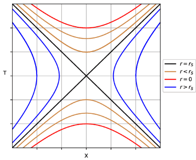

Let's take this Kruskal diagram for example:
Isn't it unambiguous that events on the blue hyperbolas are timelike separated, events on the orange hyperbolas are spacelike separated, and events on the black rays are null separated?
Yes. Those are lines of constant ##r##. But the ##r## coordinate (in systems that have one) changes when you cross those lines, not move along them, and you can move across them in timelike, null, or spacelike directions at any point. So whether the ##r## coordinate is spacelike or not depends on how you define "keeping ##t## constant", and different coordinate systems do that in different ways.
