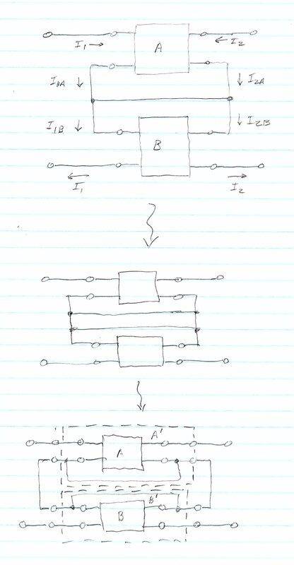

I would use this thread for a similar question.

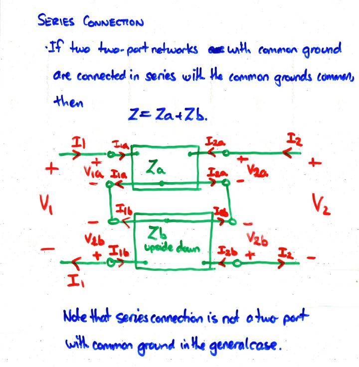

Consider the following picture about the series interconnection of two-port networks with common ground.
Why we can still use the two-port ##\left [ \mathsf Z_a \right] ## and ##\left [ \mathsf Z_b \right] ## parameters to get the overall ##\left [ \mathsf Z \right] ## two-port representation ? For a general two-port network series interconnection that is not true...we have to check for the port conditions for each of the member networks.
It seems pretty simple to just show this for each element of [Z], like I did below for Z11. Or perhaps I misunderstood your question?
edit: oops, I just noticed that you inverted the bottom network. So there will be sign errors (or disagreements with yours).

The point is that we are tacitly assuming (as in the picture) that port current constraint holds for each member network ports (so for instance for the member network A the current entering/leaving port 1 terminals are equals and the same holds for current entering/leaving port 2 terminals)
cianfa72 said:
Thanks for the reference...nevertheless it seems to not catch my point (see following)
So you're concerned that even though I2=0, that doesn't imply that I2a=0?
But all of those ground terminals are the same circuit node. There is nothing to constrain how you divide up the currents that flow from ground to ground. I think you are free to assign them however you like to make the math easier.
or, consider redrawing the problem with the four ground terminals connected on the outside of the networks. I think it's the same thing.

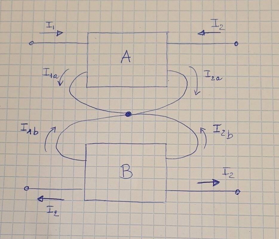

Is the following the correct drawing for what you are saying ?
Isn't that just KCL restated, which you took as a theorem in #1?
I think the image in #15 might not be correct. I am pretty sure the variable in the lower left should be I1 and not I2. Otherwise KCL at the network would be I1+I2-I2-I2=0, which will not hold for many circuits.
cianfa72 said:
Exactly, where I2a is really the current leaving network A port 2 bottom terminal.Is the following the correct drawing for what you are saying ?
yes, or something like below.

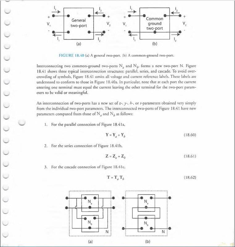

I believe it is not actually true for the series interconnection of general networks (no common ground).
Googoling I found this interesting argument from the book Linear circuit analysis - Decarlo
In the above example the series interconnection no longer comply with the port current constraints for each of the component networks.
I believe the interconnection of common ground networks is actually a special case. For the final network the currents through the '0 ohm resistors' branches building the 'large' common node are actually indeterminate, thus -- as you said before -- we can chose them in order to meet the port current constrains for each port of the member networks.

Yes. I think you are correct. That example is clear.

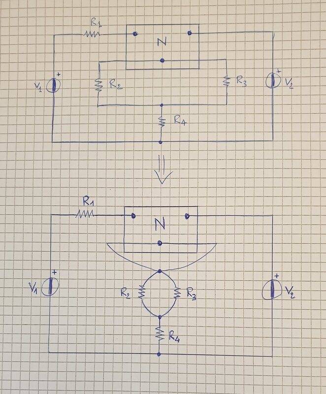

The following is a similar schema with just one network 'block' involved. To use its two-port representation in the overall circuit, I believe the depicted arrangement has to be done (at least formally).
