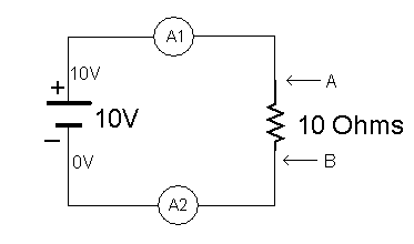

As usual: It depends. You have not specified the context. A drawing would help.

so, so let me provide you with a circuit ...
a nice simple one, a battery and a resistor
do you know Ohm's Law ? ...
a nice simple one a battery and a resistor
Yes I know
Imtiaz Ahmad said:
Yes I know
OK, good
so you have 10V across a 10 Ohm resistor ...
what is the current flowing in that circuit ?
show me your working :smile:

1 A
Imtiaz Ahmad said:
1 A
correct
so if you now increase the voltage to 20 V, what is the current in the circuit ?
davenn said:
correct
2 A
Imtiaz Ahmad said:
2 A
correct :smile:
so next, what is the formula for finding power ?
davenn said:
correct [emoji2]
P = I V
P= I (2) R

Yup
for ease we can use your first choice P = I x V
work out the two power levels for the examples we have just done
then answer your original Q ...

Is this answer corrected. If current is double
P = 2 I * 2 V
unlike voltage or resistance, current cannot just change
current is a RESULT of a given voltage across a given resistance
That is, current can ONLY change IF the voltage OR the resistance changes
And the power, in Watts, dissipated in a circuit, in our circuits above ( in the resistor)
is always related to the voltage across the resistance divided by the resistance
so for a fixed resistance, if the voltage is doubled, then the current is doubled and therefore so is the power dissipatedDave

Check again the amount by which current and power changed. They don't change by the same factor.
I royally screwed up ... I blame old age and senility :wink: :rolleyes:
@imtiaz ... humble apologies answer b) current ... should have been answer
for power
10V x 1 A = 10 W
double the voltage, the current doubles as correctly stated but the power dissipated quadruples
20V x 2A = 40W
@gneill ... cheersDave
