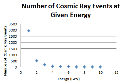

Alright, the graph looks like this:
Scatter plot titled Number of Cosmic Ray Events at Given Energy: counts fall from about 2950 at 1 GeV to about 500 at 2 GeV, then near zero by 6 GeV, through 10 GeV.

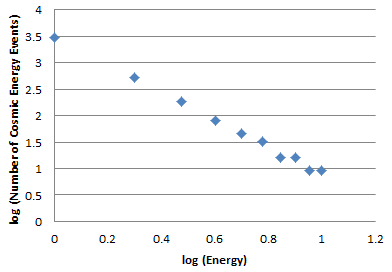

And I was thinking this was an exponential function, but when I took the logarithm of both sides, I got another (somewhat) straight line
Scatter plot of log10 of cosmic energy event counts (y, 0 to 4) against log of energy (x, 0 to 1.2), with blue diamond points decreasing roughly linearly from about 3.5 at x = 0 to about 1 at x = 1.
So I'm guessing it's another power function since the natural log of the dependent variable does not form a straight line.
