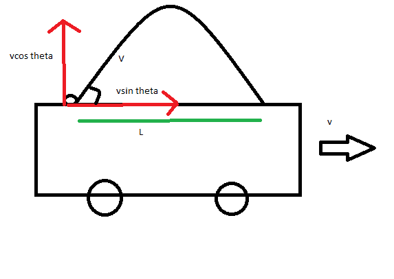

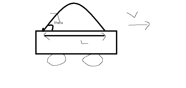

A truck travels at a speed v to the right (relative to the ground). A ball
launched inside the truck at tan theta = 4/3 has the same initial speed v (relative to truck).
An observer inside the truck measures the ball lands at a distance L from the initial
point. At the same time another observer on the ground measures the ball travel a
distance L' = xL. Determine x.
vx = vcos theta
vy = vsin theta
Hi all,
Not sure on how to start this question in the first place, but from what I gathered from the data given
I managed to derive this from the question:
##\theta = 53.13\deg##
Let inside truck be t, final position be f, and ground be g
##D_{ft} = L##
##D_{fg} = xL##
Also, for velocity (I'm pretty sure I'm wrong here)
Let velocity of ball be b.
##Vx_{bt} = cos \theta v##
##Vx_{bg} = v##
Not sure how to start this question, should I be using any form of kinematics equation or sort? Thanks

Hi.
Thanks so much for helping out.
Here's what I thought about this question:
The observer inside the truck that is measuring distance can only see the velocity from the ball itself since he is also in the truck moving, hence
##R = v^2 \sin(2\theta)/g \ ##
##R = v^2 \sin(0.96)/9.8 \ ##
However, observer at ground can see both velocity from truck and ball, hence ball 'inherit' velocity from truck too. In that case, how do I include the horizontal velocity component from the truck into this formula: ##R = v^2 \sin(2\theta)/g \ ## ?

Make a good sketch ! Showing the horizontal and the vertical components.
Will observer be seeing ball as having horizontal velocity of v + vsin theta?
Yes. Depending on your choice of theta. It's more usual to take theta to the horizontal.

So in the full expression for ##\ \ R_{\rm driver} / R_{observer} = x \ \ ##, there is one ##g## and there are two each of ##v## and ##\theta##.
Hurray ! The ##g## divides out. If the driver assigns the unprimed symbols and the external observer the primed symbols, what can you say about ##v'## and ##\theta'## ?

Stop and think for the moment.
1. If the truck observer sees a horizontal component ##V_{0x}##, what is the horizontal component ##V'_{0x}## as seen by the ground observer?
2. If the truck observer sees a vertical component ##V_{0y}##, what is the vertical component ##V'_{0y}## as seen by the ground observer?
First put the two components together to get the velocity as seen by the ground observer, then find the range as seen by the ground observer and finally take the ratio to find ##x##.
I do not mean to divert you from the course that @BvU and @PeroK have charted for you, but it is worth noting that an equivalent expression for the horizontal range is ##R=\dfrac{2V_{0x}V_{0y}}{g}## and the velocity components as seen by the truck observer are the right sides of a 3-4-5 triangle. If you answer the two questions above, you should be able to find the ratio without having to worry about ##\theta##.
1. horizontal component as seen by the ground observer is more than horizontal component seen by truck observer by V.
2. Both observer sees the same vertical component.
Will this be correct?

Yes. Point 1. is true because the truck is moving. The ground observer sees the additional motion of the truck.
What does point 2 imply? Hint gravity and time.
