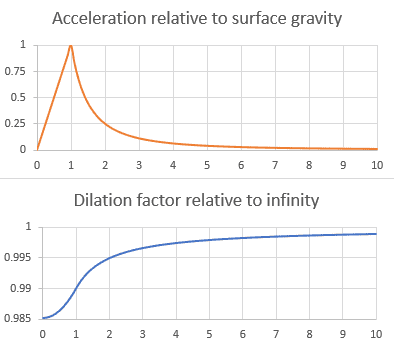

Ibix said:
You can have gravitational time dilation without acceleration, and you can have the same acceleration with different aging effects.
How would this be possible? Can you provide an example?

Being at the center of the Earth for the first, and two twins who travel at the same speed with the same accelerations at start, turnover, and end, but one turns back earlier than the other.
I was asking about this. I should have been specific.
With what observer is the observer at the center of Earth comparing time?
With what observer is the observer at the center of Earth comparing time with?
An observer "at infinity" i.e. a very distant observer.
Two line graphs stacked vertically. Top: Acceleration relative to surface gravity, rising linearly from 0 to a peak of 1 at x = 1, then falling off, against x from 0 to 10. Bottom: Dilation factor relative to infinity, rising from about 0.985 at x = 0 to near 0.999 at x = 10, against x from 0 to 10.
These sketch graphs are for an idealised planet rather than Earth. It's the shape of the curves that matters rather than the numbers. In particular, the dilation for Earth is way, way less than* the graph shown here.
(*i.e. factor much, much closer to 1)
Interesting. But infinity (if it even exists) always breaks rules and causes paradoxes. I was hoping for a more realistic example.
One other thing, doesn't the travelling observer have to synchronize clocks at the center of "Earth" and then accelerate to infinity?
