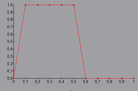

It seems you want an interval of full volume, than in interval where the volume reduces, than in interval of 0 volume, and than an interval where the volume increases. Than keep on repeating these 4 intervals?
I believe the problem is that the volume ptemp never goes back up to 1, but keeps hovering near 0, because 0.001 is subtracted and than added to it. Finally when the ( t = 0; t < tenp; t++) ends, the volume goes immediately back to 1, producing a click.
A better idea than all those counters and if, is to define a custom function of the volume during 1 beat.
You can then use a single loop where you output volfunc(beatfrequency * n /44100D) * math.sin(2 * math.pi * frequency * n /44100D)
the customfunction can be
Code:
double volfunc(double t)
	double rem = t % 1;
	if (rem<0.1) return rem * 10;
	if (rem<0.5) return 1;
	if (rem<0.6) return (0.6 - rem) *10;
	return 0;

Dude it Works!
I do not understand...
what are you doing that I am not?
why is there no ticking ??

If you plot volfunc from 0 to 1 you get this:
because of the remainder, the function repeats over and over.
volfunc (beatfrequency * n /44100D) will have a period of 1/beatfrequency (in seconds)
By multiplying the two functions you use amplitude modulation. You get a sinewave of which the volume is modulated by the result of volfunc(). It's essential that volfunc() has no jumps.
double rem = t % 1;
return 0;
A volfunc() like this will produce ticks. The modulating signal is a square wave.
