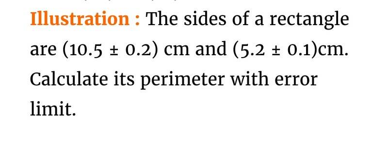

Ok that's good. Can you suggest me some(or better only one best) book(s) to me for learning more about error analysis in measurement?
I have one another function( no so complex) where I need to write expression for error. Can I ask?

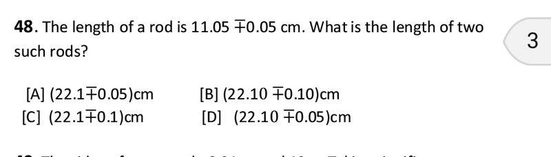

CWatters said:
If it asks for the range of possible lengths of two rods you have to assume they could both be of minimum or maximum length.
The questions straight as it is, are shown in two pictures below.
Then I believe it's 22.1(+/-) 0.4. It's not a statistical exercise.
Just for interest it's possible for tolerances to be asymmetrical. The diameter here is specified as D inches +0,000 - 0,002 meaning it won't be bigger (to three decimal places) than the nominal diameter D but might be smaller.
http://www.digicanmc.com/HTML/Sec_6/images/6-23.gif
Ok got it, thank you all.
Regards:)
