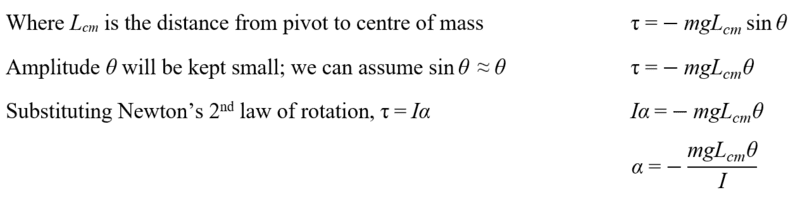

TL;DR Summary: I'm stuck trying to find the equation for time period T of a physical pendulum without any calculus using torque.
Hello all.
I am currently writing my IB Physics HL IA (high school physics lab report).
I am investigating the effect of length on the time period of a uniform rod pendulum.
I need to derive the following equation, ideally without using calculus:
This website has a good derivation but skips an important step at the end, when stating "This is identical in form to the equation for the simple pendulum and yields a period: EQUATION ABOVE". I was wondering if there was a way to arrive to the equation without jumping through hoops. If anyone could help me continue my derivation I'd be very appreciative. I got as far as this:
Kind regards
Dan
Consider a point on the periphery of a disc rotating at constant speed. What is the relationship between the disc's rotation angle at some instant, the x coordinate of the point and the component of its acceleration in the x direction?
haruspex, thank you for your response, but I don't seem to understand. What do you mean by x-coordinate?
Could you show your working out?
Many thanks
Dan
Take a disc radius r to be rotating about the origin in the XY plane at angular velocity ω. For a point on the perimeter, what is the relationship between its x coordinate and the x component of its acceleration?
