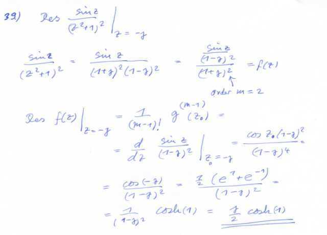

iflare
Hello!
I am studing for my Complex Analysis exam and solving the exercises for Residues given by the professor.
The problem is that for some exercises I get to a solution different from the one of the professor :bugeye:, and I am not sure that the mistake is in my calculations.
I would greatly appreciate it, if somebody could solve it and tell me what a solution he/she came up with.
Here is the exercise:
Calculate the residue of the complex-valued function [tex]f(z)[/tex] at [tex]z=-\imath[/tex], as:
[tex]f(z) = \frac{\sin(z)}{(z^2 + 1)^2}[/tex]​
My answer:
[tex]Res(f(z),\imath) = -\frac{1}{4e}[/tex]​
The professor's answer:
[tex]Res(f(z),\imath) = \frac{\imath}{2}\cosh(1)[/tex]​
Thanks a lot!

Thank you for getting involved :smile:, here is what I did, I used the formula:
[tex]Res(f(z), z_0) = \lim_{z \to z_0} \left( \frac{1}{(m-1)!}\, \dfrac{d^{m-1}}{dz^{m-1}} \left( (z-z_0)^m f(z) \right)<br /> \right)[/tex]​
where [tex]m[/tex] is the order of the pole, and [tex]z_0[/tex] is the pole.
In the particular case of this exercise,
[tex] \begin{align*}<br /> m &= 2 \\<br /> z_0 &= -i<br /> \end{align*}[/tex]
[tex] \begin{align*}<br /> Res(f(z), -i) &= \lim_{z \to z_0} \left( \frac{1}{(m-1)!}\, \dfrac{d^{m-1}}{dz^{m-1}} \left( (z-z_0)^m f(z) \right)<br /> \right) \\<br /> &= \lim_{z \to -i}<br /> \left(<br /> \frac{1}{1!} \, <br /> \dfrac{d}{dz} \left( (z+i)^2 f(z) \right)<br /> \right)<br /> \end{align*}[/tex]
My Calculations
Here are the calculations:
[tex] \begin{align*}<br /> Res(f(z), -i) &= \lim_{z \to z_0} <br /> \left( <br /> \frac{1}{(m-1)!} \, \dfrac{d^{m-1}}{dz^{m-1}} \left( (z-z_0)^m f(z) \right)<br /> \right) \\<br /> &= \lim_{z \to -i}<br /> \left(<br /> \frac{1}{1!} \, \dfrac{d}{dz} \left( (z+i)^2 f(z) \right)<br /> \right) \\<br /> &= \lim_{z \to -i} <br /> \left(<br /> \dfrac{d}{dz} \left( (z+i)^2 \frac{\sin(z)}{(z+i)^2 (z-i)^2} \right)<br /> \right) \\<br /> &= \lim_{z \to -i} <br /> \left(<br /> \dfrac{d}{dz} \left(\frac{\sin(z)}{(z-i)^2} \right)<br /> \right) \\<br /> &= \lim_{z \to -i} <br /> \left(<br /> \dfrac{\cos(z) \cdot (z-i)^2 - \sin(z) \cdot 2(z-i)(z-i)'}{(z-i)^4}<br /> \right) \\<br /> &= \dfrac{\cos(-i) \cdot (-i-i)^2 - \sin(-i) \cdot 2(-i-i)}{(-i-i)^4} = \dfrac{\cos(-i) \cdot 4(-1) +4i \sin(-i)}{(-2i)^4} \\<br /> &= \dfrac{-4\cos(-i) +4i \sin(-i)}{16} = \dfrac{-\cos(-i) +i \sin(-i)}{4} = \dfrac{-\cos(i) -i \sin(i)}{4}\\<br /> &= -\dfrac{\cos(i) + i \sin(i)}{4} = -\dfrac{e^{i \cdot i}}{4}= -\dfrac{e^{-1}}{4} = -\dfrac{1}{4e}\\<br /> <br /> \end{align*}[/tex]
The Professor's Solution
Here is the solution of the professor. This is a screenshot of the page of his lecture notes on which he solves the exercise. In his calculations:
[tex]j=\sqrt{-1}[/tex]​
iflare, the fact of the matter is that your prof goofed the derivative and your work is correct.
That is just great :smile:, thank you very much for the help!
i don't think it's so great that the prof goofed here!
i haven't taught this in a long time, so this may be wrong, but i think the idea is to separate the pole from the holomorphic part at -i.
so we have sin(z)/(z-i)^2 as the holomorphic part and 1/(z+i)^2 as the polar part.
now we want to multiply these together and pick off the coefficient of
1/(z+i)
Now to get the coefficient of 1/(z+i) it seems we just need the derivative of the holo part at -i.
by the quotient rule that should be [cos(z)(z-i) - 2sin(z)]/(z-i)^3, all evaluated at z= -i. yipes!
i.e. -[cos(i)+i sin(i)]/4 = -1/4e,
using the fact that cos(z) = (1/2)[e^z + e^(-z)], etc...
so its much easier than it looks above, but still tedious for me.
did you understand my post? the point was that if you multiply a holomorphic power series by 1/(z-a)^2, the residue at a will be given by the coefficient of the linear term of the powers eries. i.e.all the exponents of (z-a) go down by 2, so the linear etrm becomes the -1 order term.
