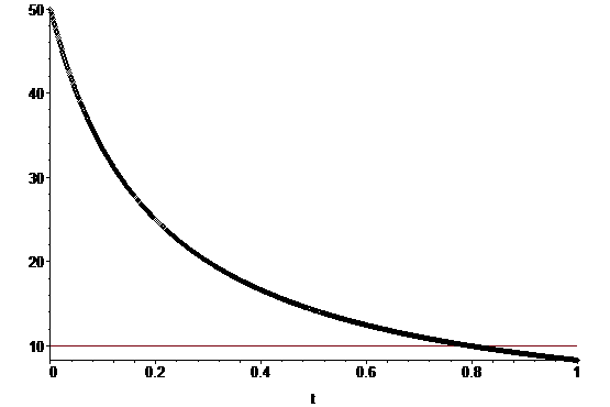

If we have object with mass 10 kg traveling at starting velocity of 50 km/s and one force of resistance that is equal to v^2 of object's velocity how can we calculate distance and time in which that object travels until it gets to velocity of 10 km/s.
Kinetic energy at start - energy lost due to work of resistance = final kinetic energy
1/2 m v0^2 - ? = 1/2 m vf^2
As you can see I have trouble calculating work done by resistance. At start it will be starting velocity squared times distance but it changes every moment as velocity changes...

Force = mass × acceleration, so if the force of resistance is ##k v^2## (for some constant ##k##) then we have ##m\, dv/dt = -k v^2##, a simple differential equation to determine ##v = v(t).## When you know ##v(t)## you can integrate to get ##x(t)##.
I solved it, first I wrote function v=f(t) then found ▲t by simply putting in final velocity. Then I integrated that function with domain ▲t to get distance.

I got ##t = 4/5## sec and distance = ##10 \ln(5) \doteq 16.09## m.

Your solution makes no sense and is incorrect. Do you know what is meant by a differential equation? Do you know how to solve the differential equation for v(t) in this problem? That was given in post #2.
If you do not know how to solve a differential equation, you can develop a finite-difference scheme to solve the problem approximately. For small ##\Delta t > 0## we have ##v(t+\Delta t) \doteq v(t) - \Delta t \cdot v(t)^2## (which becomes more and more nearly exact as ##\Delta t## gets smaller and smaller), so

Be warned, however, that we need to take ##\Delta t ## very small to get any kind of decent accuracy. For example, we can take ##\Delta t = 1/1000 = 0.001## and ##N = 1000##, to get a good numerical solution over the interval ##0 \leq t \leq 1##, that is, at values ##t = 0, 0.001, 0.002, \ldots, 0.999, 1.000.## You could do all this in a spreadsheet.
There is also a simple exact formula for the solution ##v(t)##, but I think PF rules forbid me from telling you what it is.
Below is a plot of the 1000-point curve of ##v(t)##, and the constant function v=10; you can see that ##v(t)## reaches 10 at about ##t = 0.8## sec. That is exact when we use the true formula for the exact solution.
BTW: the solution never reaches 0 exactly, just as you claimed.

Ok I see, but I don't see mass in your equation.
I quote from your post:
"v(Δt)≐50−Δt⋅50^2
v(2Δt)≐v(Δt)−Δt⋅v(Δt)^2
I believe it should be modified like this, after all acceleration is force/mass.
v(Δt)≐50−Δt⋅(50^2)/m
v(2Δt)≐v(Δt)−Δt⋅(v(Δt)^2)/m
Tell me if I am mistaken.

You are correct.
The graph I attached is correct because it used the correct finite-difference method.
