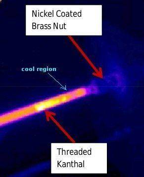

Hi I've come across a problem at work and was hoping someone could help me to understand what is going on exactly.
power supply: 6kW, 9.2A, 5890V, and running at approx 50kHz.
this power is routed through ∅3mm Kanthal AF bar, threaded at one end, and what we see is resistive heating through the bar, but almost twice as hot at the thread as anywhere else.
my first thought was skin effect, so i tried reducing the diameter of the bar but it was (almost) the same temperature at ∅2.4mm.
My question is can anyone explain why the threaded section causes so much more heat?

all of the measurements have been taken using a thermal imaging camera and when i say twice as hot, i mean on a bar half M3 threaded and half ∅3mm bar (your assumptions were correct) were approx 320°C and 180°C respectively.
An m3 screw has approximately a 2.4mm core diameter, this is why i cut a section down to ∅2.4mm, with only a small change in temperature, this leads me to the assumption that either th increased surface are, or the indroduction of a coil "wrapped" around a bar has created the heat.

i think I've attached a pdf of an image of our old connection, and you can see the peak temperature is at the end of the thread, furthest from the connection. you can see the silver soldered nut connection is creating hardly any heat, its literally being generated in the thread...
@sophiecentaur i think i understand what you mean (I'm more mechanical than electrical i have to admit!) so i'll get on that to find the voltage drops per mm over threaded and non threaded parts and find the ratio, is that right? and that will tell me whether the heat is likely due to lack of cooling or resistive issue? and yeah the material is quite consistent thoughout the temperature range, one of the main reasons we use it :)
Have we an explanation for the cool region between two warmer regions?

I wondered whether it made any difference having the rod mounted vertically or horizontally and if the air circulation at one end is different from what happens at the other. The important thing is not to include the contact resistance between the power source and the rod in your voltage measurements.
But at least an electrical measurement (you understood me correctly, I think) would eliminate one possibility.
Another thought - how uniform is the temperature distribution along the rod? Are the 'high' and 'low' regions distinct and uniform within themselves?
