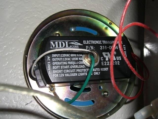

I opened it, it says 12vac 105 watts. Readings are the same. Doesn't make much sense.

Could you maybe shoot a couple pictures and post them? Also, were you able to track down the datasheet for the LED light assemblies?

Here's the whole thing then a closeup of the transformer. I can't find any other info on the leds. There's no numbers on them at all.

It says electronic transformer on the label you posted.
This means it is probably a switching mode power supply, not a conventional transformer. These do need sufficient load resistance to operate.

That looks to be a ballast, not a simple step-down transformer. Where it says "Output Frequency > 20kHz" is a clue.
It may be that your DMM can't measure that high of an AC waveform, and the extra loading just pulls the output frequency down closer to where it can start to see something.
Is it a dimmable ballast? Is there a dimming control somewhere? I tried to get the datasheet for the transformer, but am running out of time right now. If you power that light string with a standard 12Vrms step-down transformer, it should work fine.

It does say it is dimmable and I am using a dimmer which everything works fine with so long as that one incandescent is in there. Would that transformer still allow for the dimmer? Just reply when you get time, no hurry. I appreciate everyone's input.

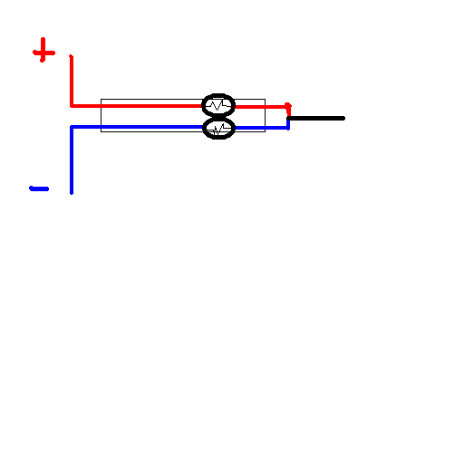

An incandescent will eventually burn out. You would be better off hiding two parallel 15 watt 15 ohm resistors. Perhaps you could simply attach them in the fitting. They are readily available.

Do you have access to an oscilloscope? On second thought, you'd need to use an isolation transformer before the 120Vrms 60Hz input side, to let you ground part of the output for watching the lighting waveform...

Not a high-voltage ballast, true. I sure wish I could find the datasheet. There are multiple MDL corporations, and I've only gotten an address for this lighting MDL Corporation, but no website yet. Lots of people sell their stuff, but no datasheets so far on those websites...
Ah, thank you! This is the info I'm looking for. If you think this will work I will definitely try it. Can I ask why 2-15's and not something closer to 105 watts?

You said that it works with 20 watt load. You don't want to draw and waste more than necessary.
20 watts at 12 volts works out at 7.2 ohms.
Two 15 ohm resistors in parallel yield 7.5 - close enough. I said 15 watt not 10 watt because they will run cooler and more reliably. Using two resistors also increases reliability.
These are also common or garden standard sizes, readily and cheaply available.
I see. Awesome. I will head to Radio Shack this weekend and grab some and report back. Thanks you guys.
