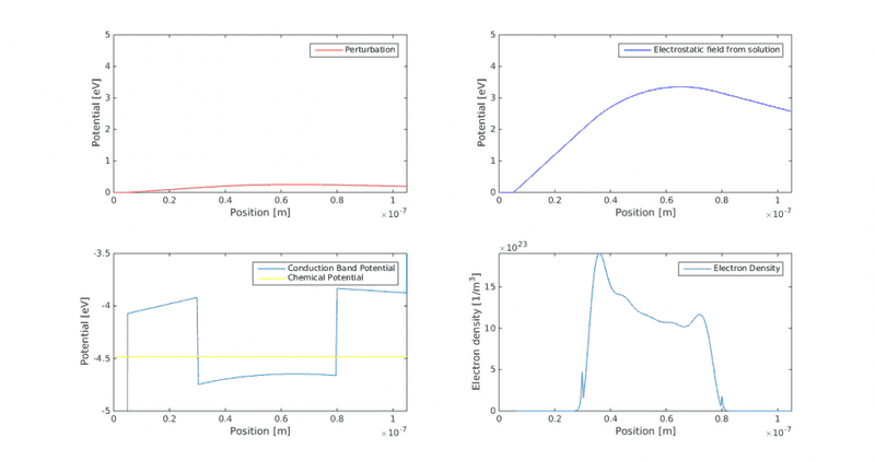

What I'm doing currently is simulating what happens when a heterostructure and metal are put together by solving the Schrödinger and Poisson equation self-consistently. Doing so I would like to see the Schottky barrier come out naturally from my approach. This is the reason why I have employed the image method. But how can the Schottky barrier come out naturally when the potential I perturb with (coming from the image method and solving the schrödinger equation in the semiconductor) is zero and the metal-semiconductor interface.
I hope you understand my question. I have an attached an example of how a simulation result could look like. To the far right there is a thin layer of aluminium, which is why I have cut of the electron density before zero because it explodes close to the metal interface.
I think the problem is that I start with a common chemical potential for the heterostructure and metal. Instead I should start with different ones and let them align by running the self-consistent scheme.

Yes I think that will be my tactic for now. Start with a chemical potential for the heterostructure and for the metal. Then allows electrons to flow from the metal until the difference between the fermi energy of the metal and the chemical potential far into the bulk of the heterostructure equals the difference in work functions. Thank you for your replies. They have been very helpful.
