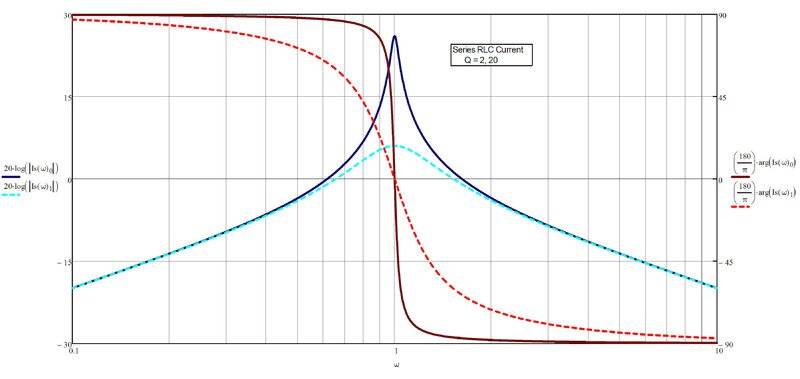

Except at the resonant frequency where it will be in phase. Really, for a theoretically losses circuit, as you sweep the frequency, it will instantly switch from +90o to -90o*, and undefined right at the resonance frequency with 0 or ∞ amplitude. Of course in the real world this can't happen, it will smoothly switch from +90o to -90o*.
Here's an example:
* edit - or from -90o to +90o for the other type.

Baluncore said:
For drive at frequencies away from resonance, the phase of the drive current will approach quadrature with the drive voltage.
You mean kind of like in the graph I posted?
Yes. You are looking at the drive to a resonator.
Off-frequency, the resonator will appear to be reactive, and so will be circulating energy between the driver and the resonator.
At resonance, the resonator will appear to be resistive, so energy will flow only towards the resonator, to satisfy the internal real resistive losses.
