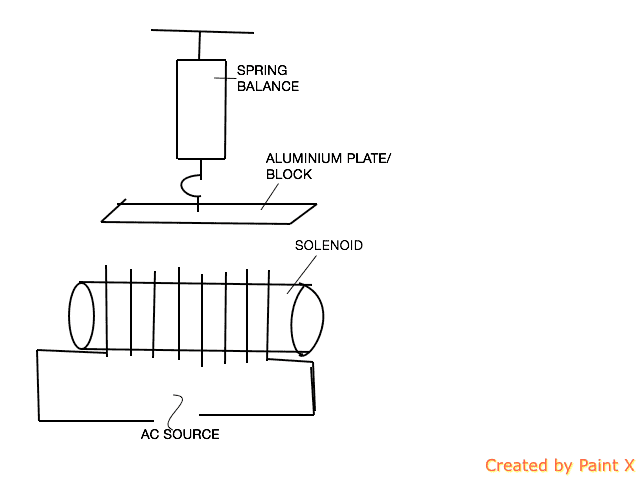

Since my Research Question is "What is the effect of conductivity of metal on the levitating force produced?" I think I should focus on the ways to calculate the magnitude of eddy current induced in the conductor plate since it is affected by the conductivity of metal, and then relate the magnitude of eddy current to the levitating force produced. I am measuring the levitating force using a spring balance. Am I on the right track?
As for stabilization, I might still be able to conduct the experiment to compare the levitating force using different metals without stabilizing the system, I'll see.
For your information, below is the diagram of my experimental setup (I am yet to conduct the experiment on Monday to see if it works)
I'm sorry if my questions sound very garbled because I'm a beginner in writing this kind of research paper. Once again I truly appreciate your help :)

You can investigate levitation force using mechanical stabilization. You may have to make several attempts... this is normal.
The spring balance setup seems ok. The levitating force would show as a reduction in apparent weight.
You may have to deal with the case that the force us greater than the weight though.
Would you expect the force to change with distance from the magnet?

Yea I can't wait to try out the experiment on Monday. If the force is greater than the apparent weight, I will have to think of a different way to measure the force tho..
The force might change with the distance from the magnet, since magnetic field strength decreases with distance. I'll try it..

One way to deal with force being bigger than weight is to increase the weight.
