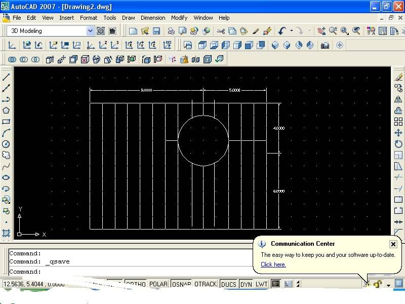

The shaded area in the figure represents a steel plate of uniform thickness. A hole of 4in diameter has been cut in the plate. Locate the center of gravity of the plate.
hint: The weight of the plate is equivalent to the weight of the original plate minus the weight of the material cut away. Represent the original weight of the plate by a downward force acting at the center(7X5in.) of the 10X14in. rectangle. Represent the weight of the material cut away by an upward force acting at the center of the circle. Locate the position of the resultant of these two forces with respect to the left edge and bottom of the plate.
AutoCAD 2007 screenshot of a 10 by 14 inch rectangular plate drawn with vertical lines, a 4 inch diameter circular hole, and dimension labels 5.0000, 5.0000, 4.0000 and 6.0000.
Answer: Center of gravity is 6.80in. from left edge and 4.90in above bottom edge

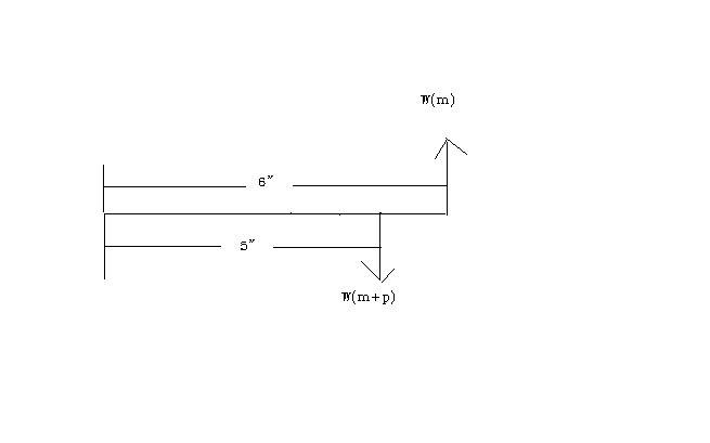

Drawing with respect to the bottom edge
Diagram of a horizontal plate with a left edge, a 6 inch dimension marked to an upward arrow labeled W(m) at the right, and a 5 inch dimension marked to a downward arrow labeled W(m+p) below.
R * y = W(p)y = 5*W(m+p) - 6*W(m)
(W(m+p) - W(m))y = 5*W(m+p) - 6*W(m)
Now I am stuck with these equations
did i do the right thing?
