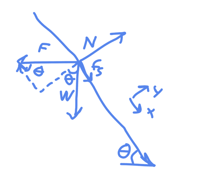

Hand-drawn free-body diagram of a block on an inclined ramp, with forces F, N, f_s and W labelled, angle theta marked at the incline, and x and y axes drawn to the right.
Above is my FBD. I got the following equations:
x: $$f_s - F\cos \theta + W\sin \theta = 0$$
y: $$N - F\sin \theta -W\cos\theta = 0$$
Using the fact that $$f_s \leq \mu_s N$$ gave the result
##F \leq \frac{W(\mu_s + \tan \theta)}{1 - \mu_s \tan \theta}##
Nvm I get it. I end up with the result: ##F(1-\mu_s \tan \theta)\leq W(\tan\theta + \mu_s)## and so when I divide both sides by ##1-\mu_s \tan\theta##, I just swap the inequality sign so that any value of ##F## that's larger than ##\frac{W(\tan \theta + \mu_s)}{1-\mu_s\tan\theta}## will work.
dl447342 said:
... I just swap the inequality sign ...
Why? Is ##1-\mu_s \tan\theta## always negative?
It's negative if ##\theta > 90^{\circ}-\theta_s##.
I was asking for a proof of why that is always the case when ##\theta > 90^{\circ}-\theta_s##. It seems that you may not be clear about this considering the edited post #6 where you say that ##F \leq \frac{W(\mu_s + \tan \theta)}{1 - \mu_s \tan \theta}## and post #9
where the inequality, although not written explicitly, is implied to be the other way.
