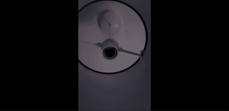

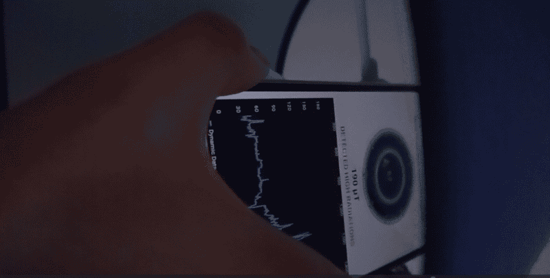

Hello. I am seeking some advice or information regarding a measurement I made using a magnetic sensor. Essentially, to summarize, I measured the socket for a ceiling light using a magnetic sensor, taking the necessary safety precautions. In so doing, in the immediate proximity of the socket, I measured up to 190 microteslas. It is important to note that the measurement was taken with the lightbulb screwed in, but the light bulb was then unscrewed and the lightbulb was measured independently and was found to give a measurement of roughly 60 microteslas so no higher than the background magnetic field strength.
Therefore the measurement of 190 microteslas came from the socket. I have attached a picture to show the measurement and a picture to show the socket, and the pictures also give an indication of how close the magnetic sensor was to the socket (it was right beside it/tight to it) and of course they also give a view of the socket itself . Additionally, the magnetic field strength in the general area of the socket but not right beside it was roughly 60 microteslas, thus the background magnetic field strength was roughly 60 microteslas. Is this result normal, what explains this result, and can you provide any further information in general regarding this result?
I have to ask some obvious questions (unfortunately, since you didn't mention some stuff...). Are these measurements DC or AC? If DC, you know that the Earth's magnetic field is in the ballpark of ##60\mu T##, right? If AC, what bandwidth does your probe support, and what frequency was this AC measurement centered on?
Can you link to the datasheet for your magnetic field sensor? Thanks.

You are probably measuring the field from the steel lamp assembly which either is weakly magnetized, is concentrating the earth’s field, or both.

Aren’t there screws or other hardware?

If they are DC, then you are most likely measuring Earth's magnetic field and residual magnetization of other nearby ferromagnetic materials, as mentioned by @marcusl
With such magnetic fields, you should be able to null them out to zero based on the orientation of the probe. What does the pickup probe itself look like? Are you able to turn the probe slowly in orientation in 3-D to minimize/zero the measured field? Also, is that your cellphone that you are using for the display in the picture in your Post #1?

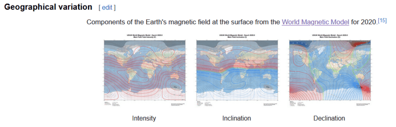

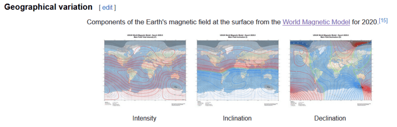

EDIT/ADD -- Are you familiar with what the Earth's magnetic field looks like in your area of the world? It is a magnetic vector field that has inclination, declination and intensity. If you are making these kinds of measurements for whatever reason, it would be good if you understood what the background B-Field from the Earth looks like:
https://en.wikipedia.org/wiki/Earth's_magnetic_field
Definition of terms: https://unacademy.com/content/neet-...agnetic-declination-and-inclination-of-earth/

I can confirm that I am using a smartphone the a magnetic sensor to perform the measurement. I did some quick research and it seemed as though smartphone magnetic sensors typically measure in DC and so I reasonably assumed this to be the case with my smartphone.

A smartphone is an imprecise sensor for this type of measurement. Why are you making these measurements? What is your goal? If you want to make precise measurements, you will need to invest in at least a moderate quality B-field meter and learn more about the Earth's magnetic field and ferromagnetic materials, IMO.

Seventhly, the field you are measuring is tiny. Perhaps 3x that of the earth.
Fifthly, smartphones have loudspeakers and loudspeakers need magnets - magnets much more powerful than the earth's field (even a refrigerator magnet is hundreds of times stronger than the earth's field) and these magnets are right up against the sensor.
Sure, the manufacturer of the phone will try and compensate for this, but they are not building a precision device. They are building a device that can tell whether you are facing north or south. If you need a trustworthy measurement, use a meter designed for the purpose. You can get a crappy one for $50.
Eleventhly, various bits of steel, e.g. screws, will distort the ambient magnetic field, so it will not just be the geomagnetic field. What you are measuring may or may not having anything to do with what you think the cause is.
