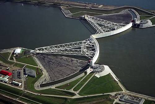

The Ike Dike just got greenlighted (a little). This would protect the Port of Houston and the petrochemical industry from storm surge buy building a retractable barrier between the north tip of Galveston Island and the Bolivar Peninsula (pronounced 'Balliver' if you aint from round here)
Ike Dike project secures initial federal funding, albeit fraction of needed amount​
A recent $500,000 allocation to the U.S. Army Corps of Engineers will be used for preconstruction engineering and design work on a segment of the Coastal Texas Project, also known as the Ike Dike. The long-planned initiative is expected to take about 20 years to construct and cost an estimated $57 billion.
Aerial view of a curved steel truss storm gate spanning a waterway, with its two leaves raised in an arc above the water and concrete abutments on either side.
