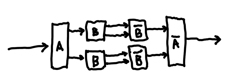

If light at a known polarity goes through a beam splitting polarizer and then goes through the reverse orientation of that polarizer it will exit with the same polarization that it entered with.
What happens if you put light through a series of beam splitting polarizers and then through the same series in reverse order with reversed orientation? Will the light exit with the same polarization as it entered? For example, if polarized light at +45 degrees goes through polarizer A, then B, then B reversed, then A reversed. Will the light exit with +45 degree polarization?

I should probably draw a picture. I thought I could explain it well enough so others understand what I mean, but that usually does not work for me.
So I don't disagree with what you just said, other than I think you are not understanding the experiment I am running. When I say light first goes through a beam splitting polarizer and then goes through that polarizer in the reverse orientation, I mean that it first goes into a polarizer where there is 1 input and 2 outputs and then goes into a polarizer where there is 2 inputs and 1 output. Or you might call one a splitter and the other a combiner.
I am pretty certain that my first assertion is true that with 1 polarizer in splitter configuration and 1 polarizer in combiner configuration it will not change the polarization of the incoming light because I read it from what I believe is a credible source. What I am not sure about is when you start to create a cascade of these, does it do the same thing.
@DrChinese here is a picture of the experiment that I want to know the result for. I believe the polarization of the incoming light will be the same as the polarization for the outgoing light, but I don't know.

The Mach-Zehnder Interferometer is different than what I am describing and have drawn. It measures interference and I am measuring polarization. It splits the beam at the beginning and then at the end where as the most simple version of my experiment splits the beam and then combines the beam. Here is a picture of the most simple version. I think the technical name for this is loop analyzer:

This is why an MZI is not the same as what I am describing. What I mean by beam splitting polarizers is a calcite crystal that separates light into two plane polarized beams. Can the MZI be used to make something similar? Also, it is my understanding that the beam splitter in the MZI splits the incoming light randomly (if you were to try and detect which way the photon went) where as the crystal splitter splits the light based on its polarization.

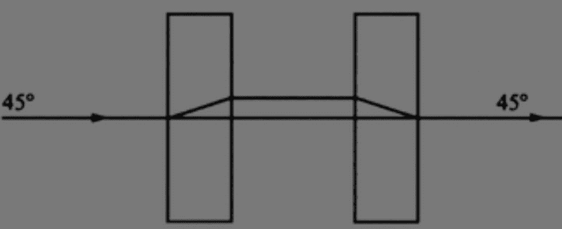

I think what you are looking for is this:
http://www.drchinese.com/David/EntangledFrankensteinPhotonsA.pdf
Figure 1 is from French and Taylor, 1979. Same as yours. As far as I know, no one has ever done this experiment. But this requires a very exacting setup. For full disclosure, this reference is to a paper I wrote.
I think it's much simpler. It's a single-photon experiment, where the photon enters a polarizing beam splitter (like the birefringent calcite crystal)
https://en.wikipedia.org/wiki/Polarizer#Birefringent_polarizers
First consider classical light (quantum mechanically that's a coherent state of not too low intensity) of arbitrary polarization. The light beam entering the crystal it's split into two beams which are polarized perpendicularly to each other.
For a single photon that means that an incoming photon of arbitrary polarization leaves the crystal with some probability either with momentum ##\vec{p}_1## and polarized in one direction (say horizontally, labelled with ##H##) or with momentum ##\vec{p}_2## an polarized perpendicular to this direction (i.e., vertically polarized, labelled with ##H##). In QT formulation such a polarizing beam splitter is leading to a photon state, where the polarization is entangled with the momentum of the photon.
Then in principle you can put another calcit crystal in precisely the opposite way such that the two beams are recombined again such that you get back the original single photon state, but that's very difficult to realize as Fench&Taylor stress, and I'm also a bit puzzled about what the authors want to teach with this example. I guess it's about interference, i.e., that you cannot simply use classical probabilistic arguments to analyze these experiments but need to use the "amplitudes".
It's much simpler to think in terms of the classical wave picture to get an intuition. Concerning single-photon experiments using only devices of linear optics, the only thing you have to keep in mind is that (a) there are interference effects as in the classical wave picture and (b) you can register one and only one photon. In our example after one polarizing beam splitter you find only one photon either in the state ##|\vec{p}_1,H \rangle## or ##|\vec{p}_2,V \rangle##. The probabilities for either outcome are proportional to the intensity of (energy density) of the classical em. wave at the position of the detectors.
