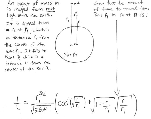

Derive n expression for the time for an object to move in space from point a to b as a result of the gravitational force of another object
MmG/r^2=F | -MmG/r=PE| PE1+KE1=PE2+KE2
I have been trying out with this one for a long time with no luck getting the exact expression. I am pretty sure this is somehow related to Kepler's third law but unable to establish the connection and the integrals I get from energy conservation yield different results. Any ideas?

Since you are given the solution and are only asked to show it is correct, "all" you need to do is to demonstrate that it satisfies the differential equation and boundary conditions.
