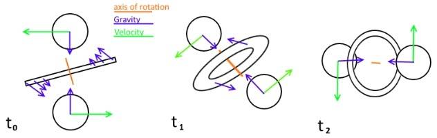

I'm having trouble conceptualizing the variables involved with this system, and I was wondering if some expertise might make the problem much simpler than I believe it to be.
Two massive spherical bodies (Osmium, minimum radius 900km, 5.08m/s^2 surface gravity) orbit each other with a solid or semi-solid washer-shaped ring of negligible mass between them, spinning rapidly. The ring is slightly tilted in the direction of the spheres' orbits. I think gravity exerts torque on the spinning ring which is shifted by its gyroscopic nature to an axis perpendicular to both orbit and rotation, but there is where I get lost because I can't picture what that will do. (I know it depends on the direction of the rotation) I've been looking at things like apsidal precession, or trying to figure out the shape of a theoretical asteroid belt before I weld all the bits together, but I just can't picture the motion.
If this model doesn't immediately deteriorate in all cases, what are the constraints of stability? Does the ring have to be entirely outside the binary orbit? If it's all about trial and error, how do I go about experimenting with this or any other model?

The ring is spinning along its ring direction?
I guess this is easier with coordinates. Let's say x is right, z is up, y is into the plane. The orbit is in the x/y plane, currently the spheres have y=0 so they are in the drawing plane.
The axis normal to the ring plane is (-x,z), pointing to the upper left. This is also the rotation axis? You'll get a net force left on the lower side of the ring and a net force right on the upper side, which means torque in y-direction, so rotation is approximately around the z axis, aligned with the orbital plane.
There is also a different way to tilt it: (x,y). Then you get torque in z-direction and rotation around (-x,y) (?)
Things get more complicated with the orbital motion, unless one timescale is much shorter than the other.
Here I've attempted to illustrate the movement as I picture it (not to scale) The ring is intentionally tilted along the axis of the orbit. The speed of the ring's rotation effectively offsets the torque acted on the disk by gravity, for reasons similar to why the globes don't just smack into each other. By the time the acceleration has changed the velocity, the velocity has taken the matter somewhere else... sorta...
The way that I'm picturing it, there ought to be some combination of speeds at which the ring's motion during orbit "dances" around the spheres without touching it. It would cause some great strain on the structure based on distances and scales and other variables. I want to zero in on what those variables are, I just don't know where to start.

The ring is larger than the spheres? That will make the gravitational forces complicated. It will also make the rotation of the ring quite slow (and therefore its precession fast), you have to take gravity into account for its internal stress, and many other complications.
Looks like you'll need a numerical simulation.
Well, we have an exact solution for the motion of the center of masses already, and the ring shape is not a point mass.
Yes, I'm hoping to somehow suspend the ring withing the Lagrange points L4 and L5.

There are no L4 and L5 for two equal masses orbiting each other.
Stability? This system is unstable. You need "infinite" precision or some active control mechanism to keep the ring in place.
