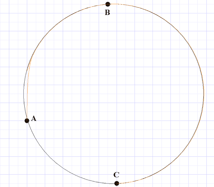

I'm not sure I should be asking this question in Maths, but I think it is a maths question and I don't care about the physics behind it.
You are in some sort of simple space craft:
It has a mass of 1kg
To move, it has one rocket that produces a constant force of 10N in which ever direction you want. (this force does not stop)
If you start from rest at position A(0m,0m) and want to get to C(10m,-7m) via B(9m,13m). Then how do you rotate your rockets (10N force) throughout your journey to complete your journey in the fastest time possible?
There is no gravity and no air resistance.
Is this question do-able? Or is it very difficult? How would I even start?

Integral said:
Yes that's exactly what I was thinking. It's significantly harder than the standard brachristochrone problem though.BTW. Just for fun I sketched those coordinates in a tech drawing program. It turns out that they very nearly lie on a 10m radius circle. With 10N, 1kg and a 10m radius turn the maximum linear velocity is 10m/s. To accelerate to 10 m/s would take a distance of 5m if directly in a straight line, though further of course if you are trying to change direction at the same time.
Taking all the above into consideration I've made an "artists impression" of what the trajectory might look like. This was pretty unmathematical and just for fun, but I'll bet it's not too far from the actual optimal trajectory. I can't help it, it's the engineer in me. ;)

This is very interesting. I took a good crack at answering this question on my own. I didn't have a calculator or a computer so I couldn't do any research .
Here is what I did:
First I solved a more simple problem, If the rocket had to get from A to B and back to A again, It would accelerate towards B until it got half way, then it would accelerate back again until it reached A. This is obvious.
Then I considered what possible paths the rocket could follow. It could follow a parabola, or a circular path (and a whole range of other ones that I couldn't be bothered considering). I went with the circular path initially. So then I simplified the problem again so It is already traveling at a speed V at a tangent to the circle. I wanted to find the force needed to keep it going in a circle. The variables I had were:

BTW the ideal solution for this problem would be:
theta = F(t)
where F(t) is a continuous function of time and theta is the angle that the rocket is pointing.
Allow me to break this problem into two parts:
Problem 1: You want to find the fastest way from point P to point Q, under the constraints:
* You start at P at rest
* You finish at Q with a specified velocity vector
* Your acceleration has fixed magnitude
Problem 2: given points A, B, and C in the original problem, choose the velocity vector through B that yields, using the solution to problem 1, the fastest route A->B->C.
(Note that the solution to problem 1 can be reversed to solve the problem of starting with a specified velocity and ending at rest)
