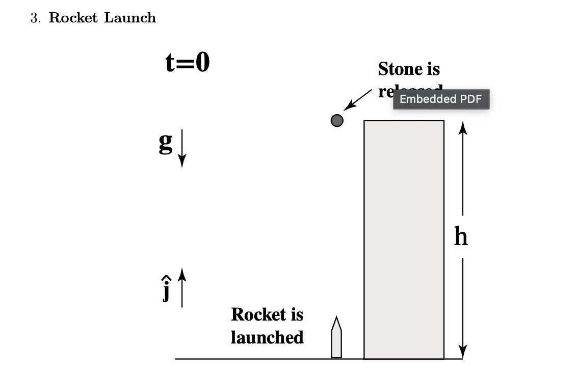

At the base of a vertical cliff, a model rocket, starting from rest, is launched upwards at t = 0 with a time-varying acceleration given by
a(t) = A - Bt
where A and B are positive constants. Also at t = 0, a small stone is released form rest from the top of the cliff at a height h directly above the rocket. (This height h is higher than the maximum height reached by the rocket.). The stone hits the rocket at the instant when the rocket reaches its maximum height. The gravitational acceleration of magnitude g, is down dropped in terms of constants A, B and g.
Total Distance = Distance traveled by stone + Distance traveled by rocket
Total Distance = distance traveled by stone + distance traveled by rocket.
Total Distance = h
Distance traveled by stone = xstone = (1/2)gt2
Distance traveled by rocket:
arocket(t) = A - Bt
vrocket(t) = At - (1/2)Bt2
xrocket(t) = (1/2)At2 - (1/6)Bt3
In order to find the maximum height of the rocket, let v(t) = 0
So, 0 = At - (1/2)Bt2
0 = t(A - (1/2)Bt)
Therefore, t = (0, 2A/B)
The maximum of the rocket occurs when t = 2A/B.
Plug t = 2A / B into the Total Distance eqn:
h = (1/2)g(2A/B)2 + (1/2)A(2A/B)2 - (1/6)B(2A/B)3

You described a physical situation. Fine. Is there a specific question that you want to answer given this situation? If so, what is it?
Obviously, the quantity h that you found in the last line is not the same as h in the drawing.
Can you critique and offer suggestions on how I can get the correct value for h? I already offered my personal solution for it. Since you say it's wrong, then I need help in obtaining the correct solution.
The h that you calculated is the position of the rocket at the time it reaches maximum height. You stated yourself that "(This height h is higher than the maximum height reached by the rocket.)" Which h are you looking for, maximum height of the rocket or the initial height from which the ball is dropped?
You need to say with an equation that, at the time when the rocket reaches maximum height above ground, the stone is at that same height above ground.
Looks to me that @putongren has been consistent in using h for the cliff height.
