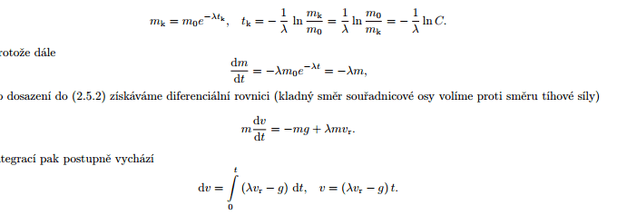

Maybe I am totally already useless today, but I got similar example in my study textbook (its from my university, and in Czech language, but i try to post it)
so I tried to solve it in this way, but I am stuck. Hope you will understant that, its just series of the formulas, and the "v" should be the result. But when I try to make my example by that way, i get nowhere. In my example is just lambda=k, and vr=u.
Ok, I just wanted to see how you got m(dv/dt)=-mg+kmu.
Now, that g is the gravitational acceleration at radius r, so should really be written gr to distinguish it from g at Earth's surface. Rewrite it in terms of the surface g, Earth's radius R, an the rocket's radius r.
