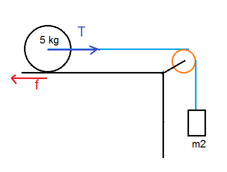

A solid cylinder is attached by a rope on its center.It has mass of 5kg and is lying on a table.The other end of the rope is a block of mass m2 which is not on the table .if the coeficient of friction between cylinder and table is 0.2.Find the maximum mass 2 so that the cylinder rolls without slipping.
F=ma τ=I α
Because it is rolling without slipping;f=1/2*5*a
T-f=5*a m2g-T=m2a and the a of cylinder centre is the same as a of the object.but i am stuck with bot knowing the accelleration.And is the coerficient of friction of any use ?

I think this is the set-up: the rope is attached to the axis of the cylinder :

You know that the maximum friction can be f=μ(5g).

You are right. But the problem makers usually think in two dimension :) The OP followed that scheme shown in my picture, his only problem was that he eliminated the known force of friction, and so he had two many unknowns.

Ehild's picture is the problem i was trying to interpret.Is such problwm solvable? I don't know if the variable a and m2 can be solved with the dynamics equation.
Remember the problem text
You did not calculate with the friction although the coefficient of friction was given. If the cylinder rolls, there is static friction between the cylinder and the table. The static friction is f<μmg, m is the mass of the cylinder, 5 kg and μ=0.2. If the cylinder has so big acceleration, that the force of friction reaches μmg, the cylinder is on the verge to slip. You know that maximum force of friction. Instead of eliminating it from the equations, determine the acceleration a and the mass m2 from the condition that f= 5*0.2*g
