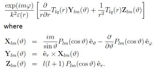

The solutions look like:
Equations defining vector spherical harmonic solutions: exp(imφ)/(k²ε(r)) times [∂/(r∂r) T_lq(r) Y_lm(ϑ) + (1/r²) T_lq(r) Z_lm(ϑ)], with X_lm, Y_lm and Z_lm defined in terms of P_lm(cos ϑ).
So far all that I have been able to find is that rotations of these solutions can be expressed as a linear combination of them over different l's. What I am unsure about is what the weighting is of this linear combination. I have found some people state that it is the Wigner D function (with an unhelpful reference), but after doing the calculations it doesn't seem like these work as I would have expected.
It's hard for me to distinguish between bad coding and bad intuition at the moment because I haven't found much information about such rotations online.
Is the Wigner D function the correct waiting? Are there some other rotation matrix elements that I should be using as the weighting? Does anyone know of anywhere I could find some more information to learn this properly?

For example, referring to the harmonic X, in the picture of my first post, if you were to write this in another set of co-ordinates it would look like this:
Equation: X_{l,m}(θ', φ') equals the sum over m' from -l to l of D^{(l)}_{m',m}(α, β, γ) times X_{l,m'}(θ, φ).

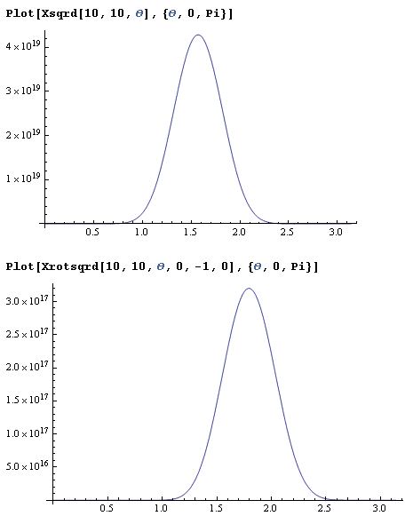

The problem I have now is that if I plot the norm of the original harmonic as well as the norm of the rotated harmonic, not only is the function not rotated by the amount I tell it too, but there is a larger (factor of 100) drop in the maximum value of the norm.
Two line plots of norm values against theta from 0 to pi. Top: Plot[Xsqrd[10, 10, theta]] peaks near 1.6 at about 4x10^19. Bottom: Plot[Xrotsqrd[10, 10, theta, 0, -1, 0]] peaks near 1.8 at about 3.2x10^17.
Instead of the peak shifting by 1, it only shifts by a little, and as you can see there is a large drop in the magnitude of the norm.
Can you see something that I'm doing incorrectly? I don't think the size of the norm should drop at all, it should be the same no matter what rotation is made.
