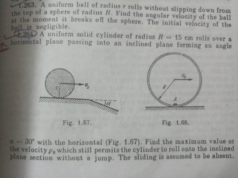

I have attatched both the problems. The figure is essentially the same.
1. Energy conservation
2.mgcosx - N = mv^2/r , where N is zero in limiting case.
I solved the whole question and got the answer given in irodov(0.33 gR(7cosx-4))^1/2 .
But answer given in krotov is different.
So, there must be a difference in questions but i am unable to grasp it.
Thanks in advance.

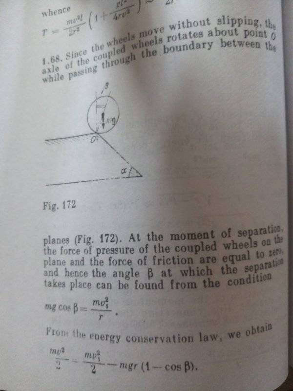

haruspex said:
The moments of inertia are different.
Well, in the detailed answer Krotov has ignored Kinetic energy due to rotational motion completely.His final equation is
mv^2/2 = mV^2/2 - mgr(1-cosx).
Anyways, moment of inertia of solid cylinder and disk are same
