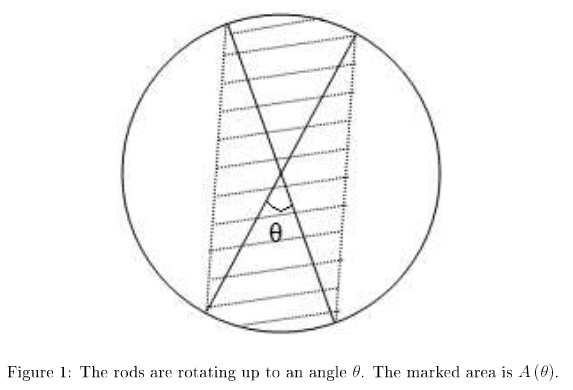

For translational, I should calculate the free (non forbidden volume) for molecule to move in. Since the overall volume is V and there are N molecules, the volume allowed for moving is:
[tex]W_2 =V-NA \left ( \theta \right )[/tex]

1. Do they mixed up between Omega and A? Or it's me?
2. Where do a factor of 2 came from in the expression for the volume?
