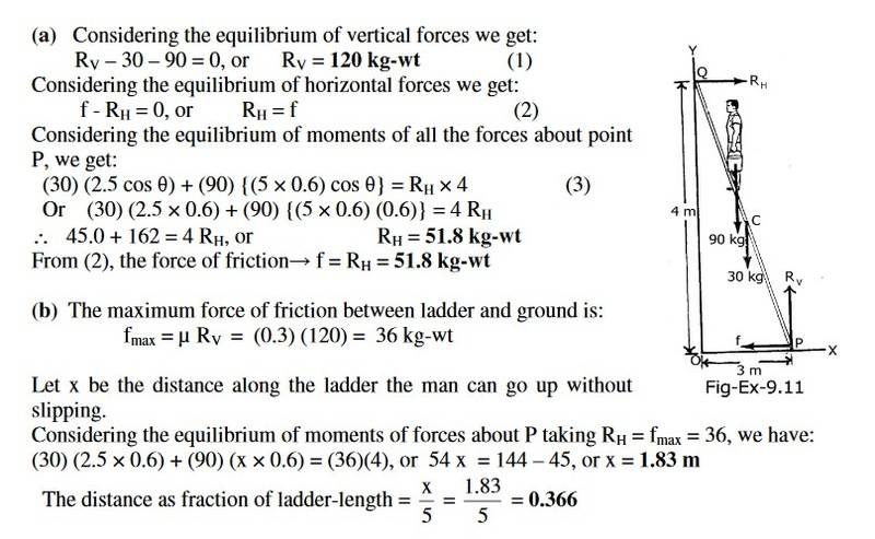

Hi everyone,
Our professor gave us a bunch of solved problems to practice with before the exam, and this one I'm struggling with:
I'm trying to work through the solution step by step, and I get stuck at the point (3).
What I understand is that we want to get the value of RH, which is equal in magnitude to friction. So to do this, we do rotational equilibrium - the total of all the moments must be zero.
What I don't understand is why is it set equal to RH times 4? I don't understand this. RH is acting at the end of the latter, which is 5 meters long. Shouldn't it be RH times 5 instead of 4?

When you calculate torque produce by Rh taking pivot point at ground then
Torque =perpendicular distace from pivot to direction of force χ Rh
Thats why here 4 is taken not 5

It could have said Rh x (5 m) x sinθ. Note that in this case with a 3-4-5 triangle, that sinθ = (4/5). So Rh x (5 m) x sinθ will equal Rh x (4m).
CORRECTION (fixed now). I should have said sinθ rather than cosθ

Ohh I think I get it... it's because Rh is in a different direction than the weight of the man and the weight of the ladder, so we multiply it by sin rather than cosine, and 5 times the sin of 53.1 is 4?
It's a bit unintuitive for me (I haven't done trigonometry since the late 90s...!)
I think the drawing is a bit unhelpful, it's easier if I re-draw the ladder as a straight line to show the forces at their angle so it becomes more clear)

and I know it's just supposed to be a sketch, but their drawing isn't even close to being scaled (3-4-5) triangle. ?:)
