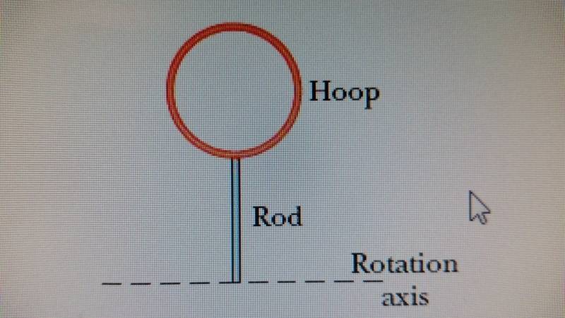

The figure shows a rigid assembly of a thin hoop (of mass m = 0.25 kg and radius R = 0.13 m) and a thin radial rod (of length L = 2R and also of mass m = 0.25 kg). The assembly is upright, but we nudge it so that it rotates around a horizontal axis in the plane of the rod and hoop, through the lower end of the rod. Assuming that the energy given to the assembly in the nudge is negligible, what is the assembly's angular speed about the rotation axis when it passes through the upside-down (inverted) orientation?

The rod and hoop are rotating about the end of the rod opposite of the hoop, so don't worry too much about calculating the MOI about the c.g.of the combo.
Be careful about which formula you use to calculate the MOI of the hoop about its c.g. If you are using a table of formulas, inspect very carefully which formula goes with which axis of rotation. There's two different formulas for the MOI of a hoop.
