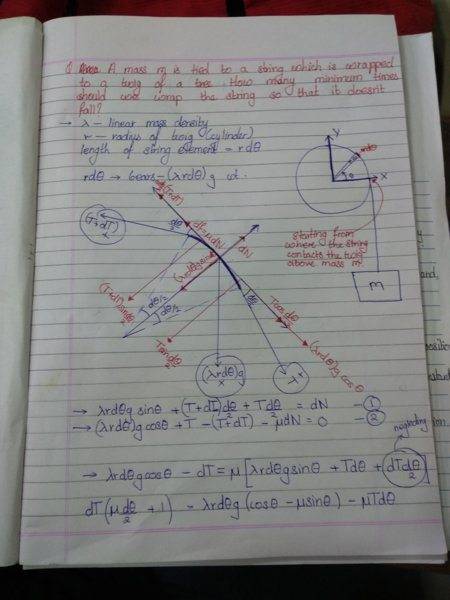

A mass m is tied to a string which is wrapped to a twig of a tree. How many minimum times should we wrap the string so that it doesn't fall?
Here is what i got...
1.There is friction between the twig (or fixed cylinder) and the string.
2. if the total friction between the string wrapped around in 1 circle around the cylinder it will be a piece of cake.
3. The thing is that i am unable to find that because the operating friction force at every point from the free body diagram will be different

Let the string have linear density ρ and the cylinder radius r.
If we consider a string element length rdθ at angle θ above the horizontal (starting where the string contacts the twig above the mass), it has weight ρgrdθ.
If the tension there is T(θ) then by force balance we can obtain the differential equation
##\frac{dT}{d\theta}=gr\rho (\cos(\theta)-\mu\sin(\theta))-\mu T##
This much you might be able to find for yourself. Since you are unfamiliar with calculus I will lay out the solution I found.
When the smoke clears:
##T=ce^{-\mu\theta}+\frac{gr\rho}{1+\mu^2}[2\mu(\cos(\theta)-1)-(\mu^2-1)\sin(\theta)]##
At θ=0 we have T=Mg, so c=Mg; at the other end, after n+½ turns, θ=(2n+1)π and T≤0.
##2n+1≥\frac 1{\mu\pi}\ln(\frac{M(1+\mu^2)}{4r\rho\mu})##.

@haruspex please explain how that differential equation came... Cause i tried and mine is different... The rest of all i understood!
Maybe mine is wrong... how about you post your own derivation?
I was surprised by the solution I got to the differential equation. It says something strange happens for μ>1. I think this just means that with a high enough coefficient you would not even need a quarter turn of the twig.
Likes Priyanka88
Damn i got the equation! Thanks man
Check this if anyone wants to see the differential equation
